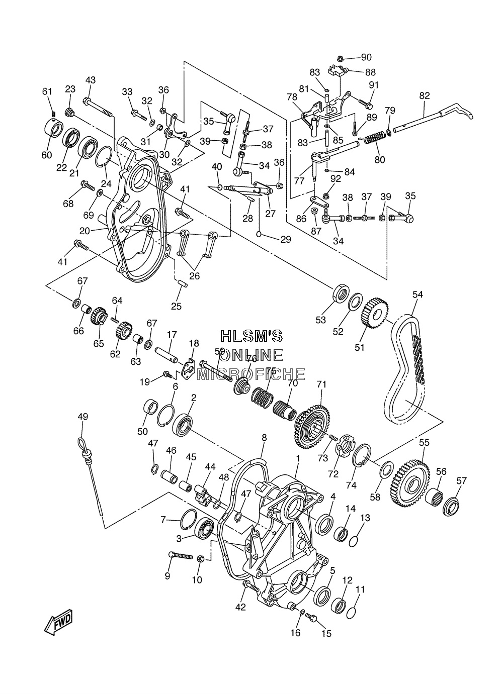

maddogjeff said:So, are we talking about the gasket, part # 8 on the fiche?
Yep!
