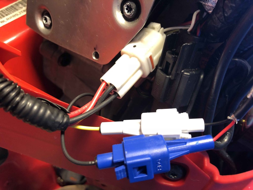

I was ecstatic when I got a PM from Patrick at GAP last week. He wanted to get their new handlebar switch out for beta testing. I was more then happy to accept! He contacted me just a couple days before we were heading to Qc, and so he quickly shipped it out to me(2 days) so I would have it here in time to install it before trip. Huge thank you to Patrick and GAP for EVERYTHING they have done from software and now to hardware, and reaching out to me, thank you guys!

GAP Momentary Map Switch
Some very cool things came out of this trip and switch testing. Since the beginning, I was more interested in map switching then just about any other aspect of the tune. Reason is, for my area i like to rev my sled higher on tight trails which gives me ultimate snap corner to corner. I prefer the 270 or 290 maps on my tight trails, so when I crack throttle it will instantly lift nose. To get the snap to be instant you cannot have the weights too heavy, and of course you MUST run a Early spool Hurricane tune, which comes on with big boost down around 5k.
The downside of this is when you get to a lake, you now will be revving 9100(270map) and higher on 290 map. While the 240 map will be about perfect at 8800-8900. So this was abit of a pain most the season, but now with the GAP Handlebar switch, I can instantly flip up/down in HP and run it where I need to for the trail/lake im on. The best part of having the switch is now you can change MAP on the fly, and truly "feel" the power differences. Really nothing is as cool as this setup!
I also did some testing up north with fuel. With the knock light protection we have, it allows us to know exactly when we see knock from low octane fuel. With that in mind, I did some testing with 87 octane on this trip. I found that I could ride the entire trip on 87 octane at speeds up to 85++ mph on the trail, all day long and never see any knock light. Now that means trail riding, not holding it WOT. I did hold it WOT and the knock lite will start to flicker within a few seconds on 240 map, and even sooner on 270map. But when trail riding you dont normally hold it WOT for any long period of time, and I could run super hard at very high speeds the entire trip with NO KNOCK on 87. Now I dont recommend doing this, but it sure is nice to have this knock protection from GAP, so when you can only find 97 octane you dont need to worry.

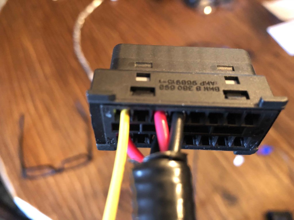

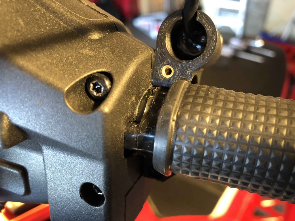

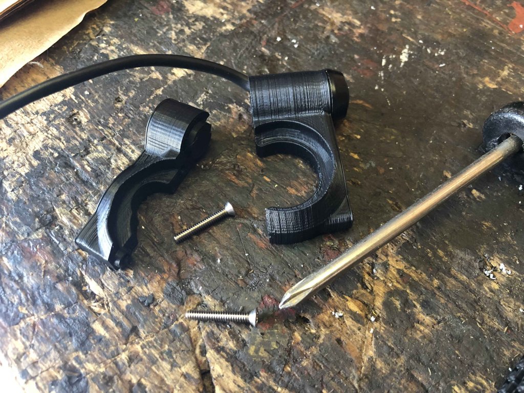

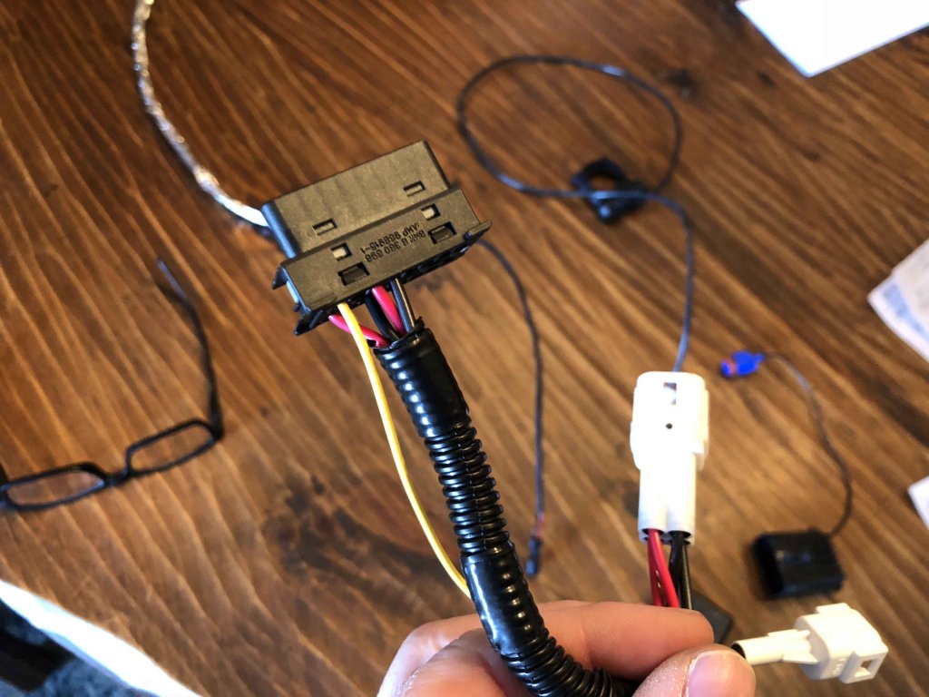

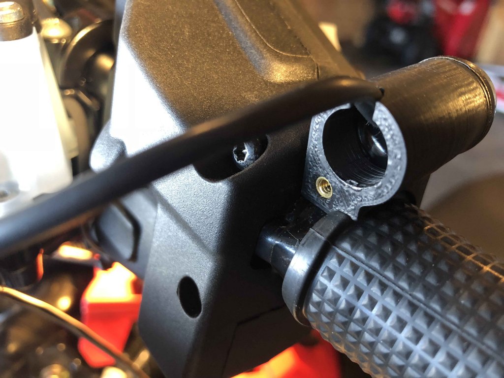

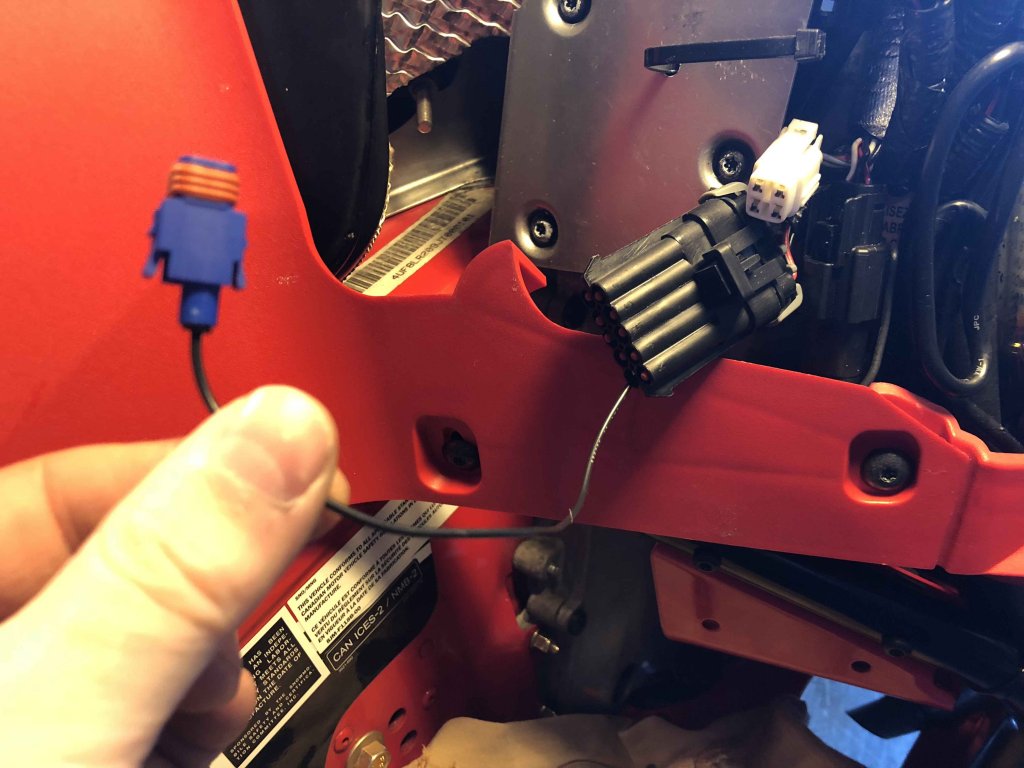

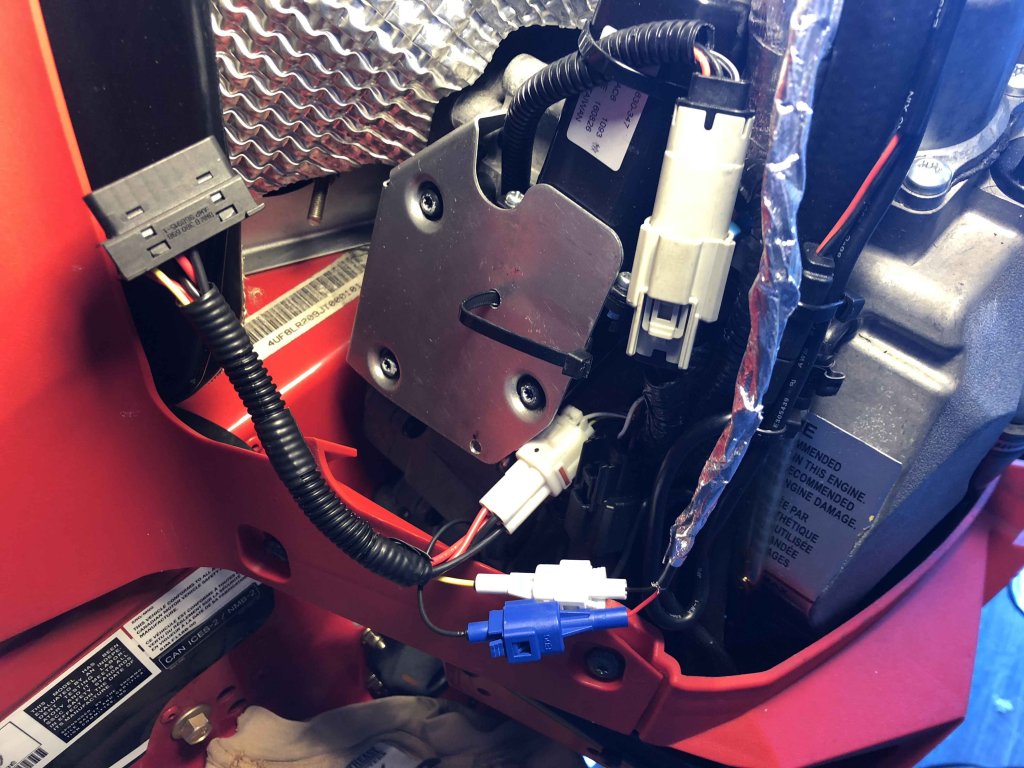

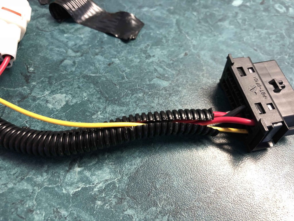

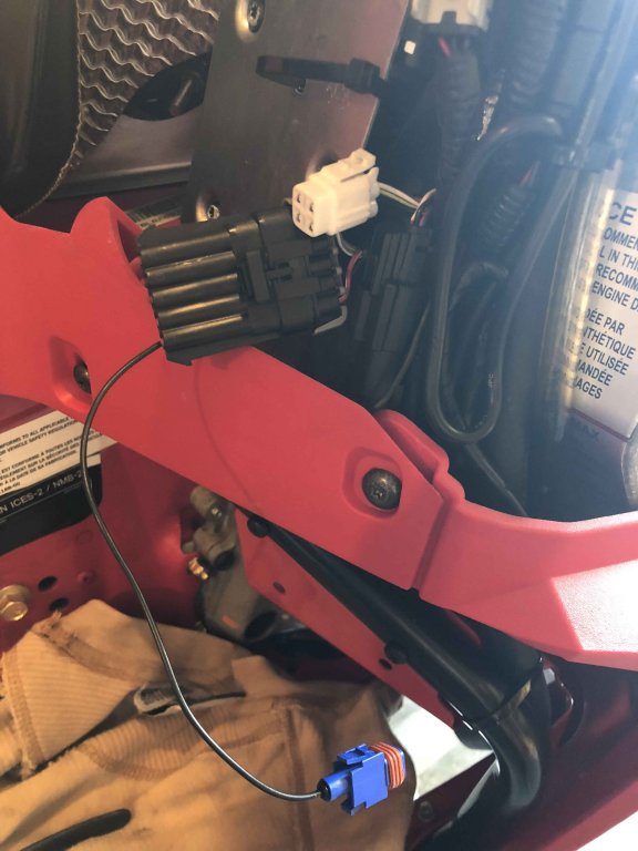

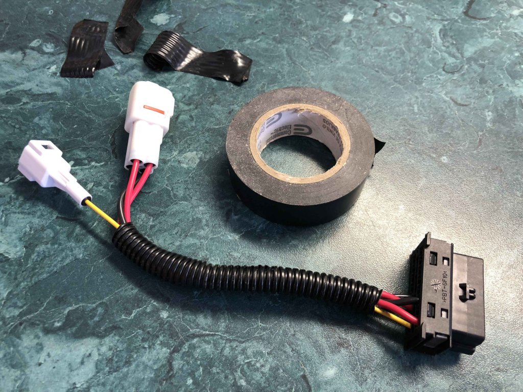

Few pics of new switch install:
View attachment 139484 View attachment 139485 View attachment 139486 View attachment 139487 View attachment 139488 View attachment 139489 View attachment 139490 View attachment 139491 View attachment 139492 View attachment 139493 View attachment 139494 View attachment 139495 View attachment 139496 View attachment 139497 View attachment 139498 View attachment 139499 View attachment 139500
