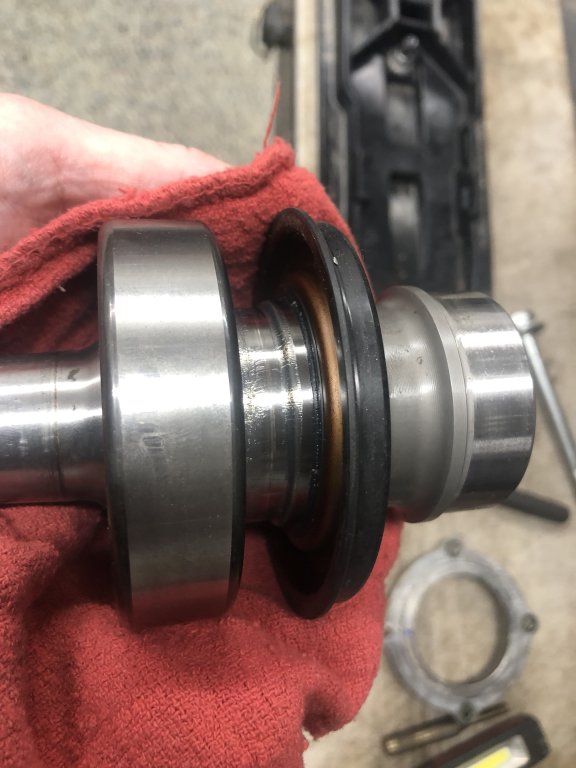

How are people getting the inner seal properly installed during shaft installation?
Just stuffing the whole assembly in does not seem like it would go far enough to install the inner seal properly, or if the seal does go in it would not ride on the shaft properly?
Am I missing something? Does it matter?
I have the shaft out, and looking at it, it seems as though the shaft has to be installed first, install the seal, then the bearing after.
I have always installed the stubshaft, bearing, seal, and collar as a preassembled unit. I have not experienced an issue with the seal.

But when doing this, the seal does not get pressed into the block, correct? The bearing does not go far enough to press in the seal. At that point, why not take the seal out? If the seal does not get pressed in the block, does it flop around in there, spinning with the shaft?

Yep, your wrong. The seal gets pressed in upon installing the complete stub shaft assembly.

The housing goes over the bearing, (clean and loctite first), and the seal gets pushed into place on assembly.
The seal rides next to the bearing on the smaller portion of the shaft, as you have it now its stretched over where it actually rides. This happens when you pull it out as an assembly where its pulled onto the next step up.
