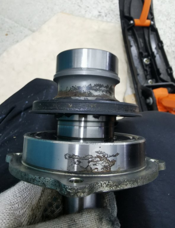

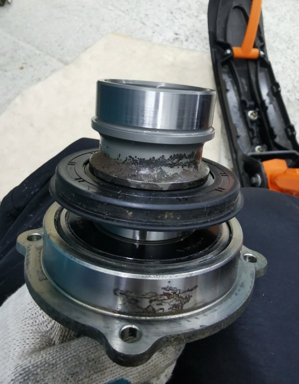

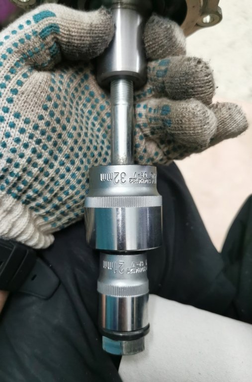

To remove the shaft, I used this method, it worked perfectly, like a reverse hammer. Two heads of 21 and 32 mm. So as not to spoil the bolt.
After removing it, I found rust. Is it dangerous?
I'm going to change the bearings and install a new seal. It is also seen that the shaft and bearing have shifted.

I have had a few stub assembly's out and they can corrode in some areas - around the inner housing and even in the inner part of the shaft with the splines (like your pic). Take some time while its apart and clean them up with a small wire brush. On the housing, i used the grinder with wire wheel.To remove the shaft, I used this method, it worked perfectly, like a reverse hammer. Two heads of 21 and 32 mm. So as not to spoil the bolt.
Normal - nothing to worry about. Does make you wonder about the condensation inside the motor.
When i have installed it back on - i will pack the splined area with grease so that internal area is well lubricated and no rust will form.
