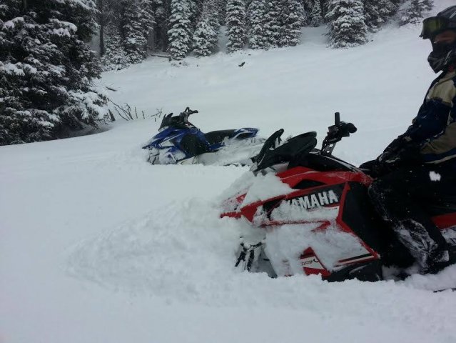

$60.00 spring and 15 minutes makes a world of difference in setup. I mean BIG change for the better. More skid transfer means better traction along with better ride. Both these in the pics have been modified (and are NOT stuck...lol)
