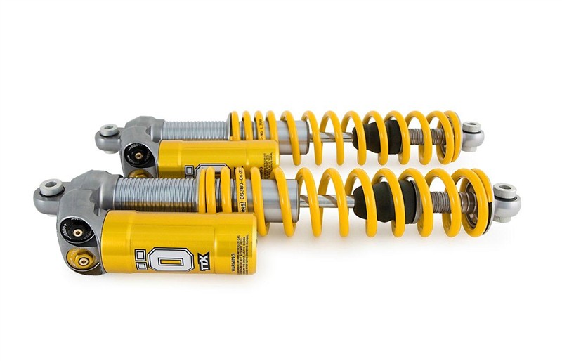

Custom Ohlins TTX44 w/ PDS for the 128" Mono.

Drool……..Custom Ohlins TTX44 w/ PDS for the 128" Mono.

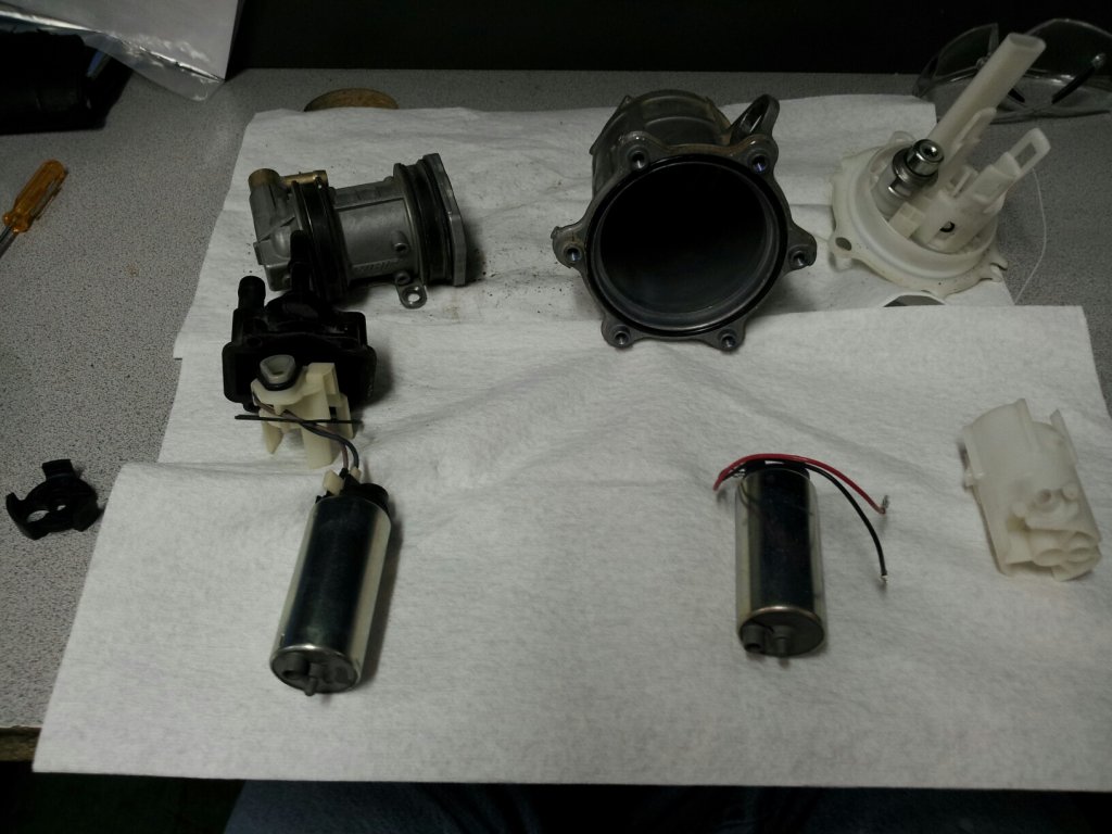

The only thing I've been mulling over is the fuel tank and pump. Placing an EFI pump in the stock tank won't be easy... but no matter the tank, the issue will be easily solved with an externally mounted fuel pump sump/surge tank. Fuel starvation will not be an issue, and if done correctly, it will be good to the last drop. There are two OEM Keihin external sumps that might just fit the bill. They come from Suzuki and Honda ATVs. I suspect the Yamaha pump with fit... but need to check. The Suzuki LTR 450 pump is on the left, is smaller, and holds less fuel. The Honda Rincon (and other Hondas) is on the right, it has a larger sump. I'll probably go for the Honda unit as the room to mount it exists, it also has the regulator built like the stock pick up. Hopefully flow and regulator are comparable, or easily swapped.

I reopened my account with Ohlins, and while all the snow stuff has to come out of Sweden, I managed to pick up a few sets of nos TTX30 snow shocks here stateside. Eventually we’ll have TTX all around on this machine. I might let a set or two of the TTX30 go if anyone is interested?
