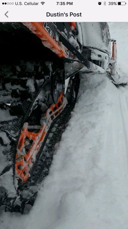

You beat me to it.View attachment 124397 Keep your track tight enough this one racheted and rails stabed the track!

That blows. I'll verify and correct. Thanks to everyone....View attachment 124397 Keep your track tight enough this one racheted and rails stabed the track!

Just Curious on the pic with the bent rails. Was it ever confirmed that the loose track caused it? He mentioned he was missing lugs too.

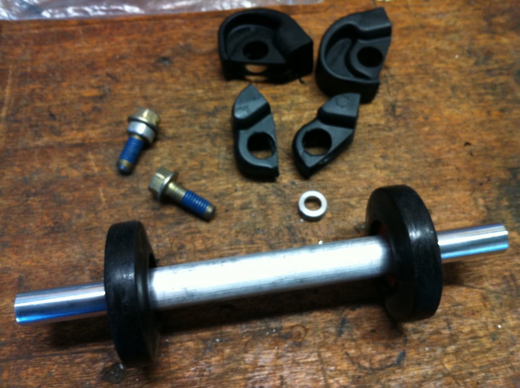

anti-stab rollers would prevent that from happening again.View attachment 124397 Keep your track tight enough this one racheted and rails stabed the track!

That must have been beyond loose....nothing like jt pic...
I added anti stab to my attak and think their a great idea and should come standard...

Can someone explain how a track loose enough to ratchet allows the rails to stab it? Always ran every sled by loosening till it rachets then tightening up slightly.

Twiz, look under your skid. Imagine that the track is being pulled by the drivers and "sticks" or follows the driver around a bit. Now the track kind of bows up between driver and rail. Skid moves, track sticks/bows at wrong time and rails catch on windows. Hope this helps. I like running track on loose side now that everything has extrovert style drivers so always run anti stab shaft.

Thanks for the explanation, I've never seen it happen but see how it could. Might look into anti stab myself, always run loose.
