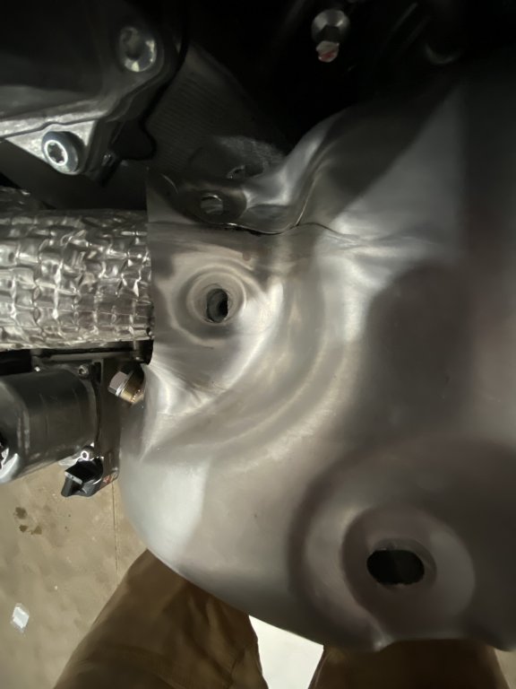

To the guys that have this exhaust how n the hell did you make your stock heat shield work no welded brackets on it and I can’t get the shield down far enough to thread the short bolts into these holes if I have to I’ll get longer ones

To the guys that have this exhaust how n the hell did you make your stock heat shield work no welded brackets on it and I can’t get the shield down far enough to thread the short bolts into these holes if I have to I’ll get longer onesView attachment 161159
Go to a post right above yours. “Header Vs. Quiet Performance muffler w tunes”
Last page has some info on what some have done to the TD SQ2.5”
Might give you some ideas!

Hey jd. I have that muffler and was able to use oem screws. Only one of 3 torx style on top though. Not the best fit IMO.

I ended up using a Dremel tool had to do a little cutting to make it fit rightHey jd. I have that muffler and was able to use oem screws. Only one of 3 torx style on top though. Not the best fit IMO.

I use studs in the eexhaust manifold where the shield attaches. Those two bolts are a pain in the buttI ended up using a Dremel tool had to do a little cutting to make it fit right
First, take purse and hit circled areas in direction of arrow. Next, use hands to bend the squared area down toward the pipe. Lol I'm just joking. I have two sleds with the TD 3" Super Quiet. That heat shield is very thin, malleable metal. Just massage to fit.

Lol I ended up cutting some material off with a dremel tool fits better but ain’t perfect guess it’s better than melting my hoodFirst, take purse and hit circled areas in direction of arrow. Next, use hands to bend the squared area down toward the pipe. Lol I'm just joking. I have two sleds with the TD 3" Super Quiet. That heat shield is very thin, malleable metal. Just massage to fit.
Definitely better to run the heat shield. Nice work.
