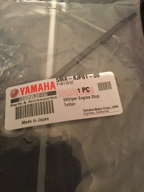

I removed the roll over valve and wanted to add the safety tether as added insurance; (even though the roll over valve doesn’t do anything if your sled is still running on its side - it’s really a simple check valve -Lol). Also as a note the tether is the same one as the Viper, and the kit was purchased in Ontario.
I consider myself to be pretty mechanically inclined, but this job really tested my patience so I’m hoping I can help make it easier for the rest of you who decide to install a tether. It took me about 3hrs with a trip to Canadian Tire to do the job.

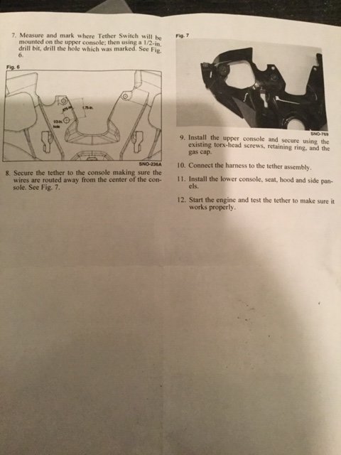

11. Drill a hole in the plastic with a 0.5” drill bit per the instructions and install the switch. Install it somewhere on the center pc that does not remove with the hood or side panels. Connecting the tether wires is a bit tricky, the connectors look like they don’t fit but play around for a bit and you will figure out that they do work and one fits very very tight, to the point you are ready to take it back.... !!
12. Follow the rest of the instructions to finish up

That's not the Tether I used on my Cat. Mine used a plug on left side of sled. Drilled hole plugged in plug and done. That looks like the old tether for the 1100T.
The new version is magnetic.
