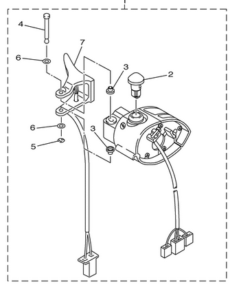

so this past winter the clip that holds the throttle in the throttle block broke. Ride a 2012 nytro xtx by the way. Went to the dealer they said order a whole new assembly. I don’t want to go that route. Anyone ever run something aftermarket for a throttle and kill switch. Also probably going to go to a tether as well. Thanks in advance for the reply’s

What clip are you looking for? Number 5 the "C" clip or the clip that holds the cable in the throttle block? If it is the clip for the throttle cable I do not see that one listed in the Yamaha micro fiche. I would call Kevin at Port Yamaha who is the best parts guy in the business. If he cant help you the contact Travis at Barn of Parts (BOP) and he might have a used part. G.B.

Not the number 5 clip it’s a clip that’s inside the throttle block. I’ve looked at parts diagrams in hopes of finding one but like you posted above it doesn’t show much. Do you know anyone who runs anything aftermarket like a billet one?
