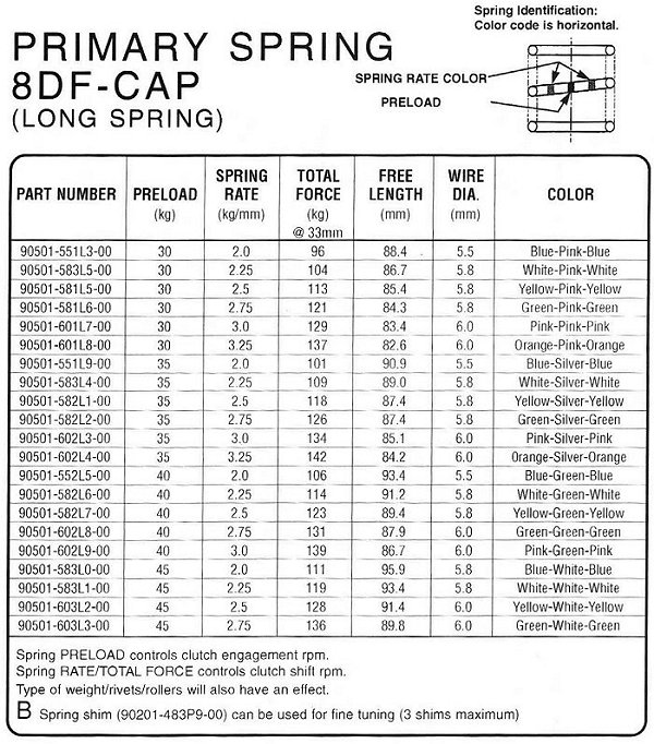

I’m going through my clutches on 14 xtx. It has a thunder products heavy hitter kit in it. Does anyone know what the spring rate is on their blue secondary spring? I called them and they don’t know......

Also what twist should I be using? I’m new to clutching. Currently has a stock helix, will be going to a reverse helix shortly just trying to get everything else working right. I’m not getting all my RPMs on a wot run. Only getting 8100 range. I’m putting a stiffer spring in the primary, currently a blue silver blue.

Another guy I talked with suggested a Dalton Red spring, which i happen to have one from my Apex. The spring rates on it are 40kg and 133KG total.
If you already own that spring I would try it. It only cost you about 15 minutes of your time to switch it out. Nos-Pro has also given you some recommendations that stick with the blue-silver-blue spring. He has a lot of experience with the TP set up. As a generalization changes with the clutch weights will make a bigger difference than changes with the spring.
Make only one change at a time and keep written notes of how the different calibrations have affected the shifting. You might believe that you will remember but written notes can be referenced a long time in the future. Your recollections may fade.
Like I said i'm new to clutching and trying to understand what does what. At this point I've had people tell me to take weight off and leave the spring, others have said at that weight I need a heavier spring. I'm just trying to make sense of everything and figure out whats the right way to get things working. The guy that said to go heavier spring didn't think enough weight could be removed to gain 800-1000 rpms? They currently have 8 or so grams that can be removed based on what my scale showed. 3.3 in the heal, .4 in the mid and 4 on the tip. The base weight is around 58 grams roughly. We don't have snow currently so I can't go out and test it without driving 4 hrs up into Michigan.
