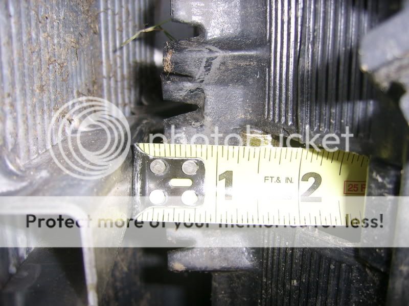

Ok I've been asked about track size (lug height) I feel the if you were to stay with the stock drivers there is only about 1/4" between the heat exchanger protectors and the tip of the stock 1.25" track. Once these are removed I feel a 1.75" track will clear even the next tight spot that is where the exchanger/tunnel/bulkhead all meet.
Here are some pic showing area of how tight the track and exchanger protectors is.
Topgun
Great pics. I can see the protectors definitly have to go in my case.
