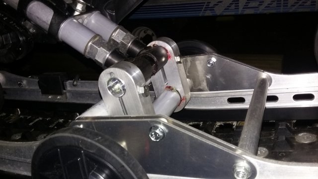

looks good sprint cat. i think the star kit will be my ONE, mod next year! sucks i have a full hygear shock and spring package on the sled now. not sure how it will all work together. On a side note maybe im wrong but that bolt/nut on the top of the front skid shock shouldnt be bending the metal mount that holds shock eye. Not sure if it was like that when you got it or just got a little zealous with a wrench.

Not sure if know what you think it should look like ? To tight ?

That's how it looks from the factory!! What is the torque specks? maybe it's to tight. I snug ed it up all the way.now I am going out to look at it , u got me wondering. It might just be the angle of the picture

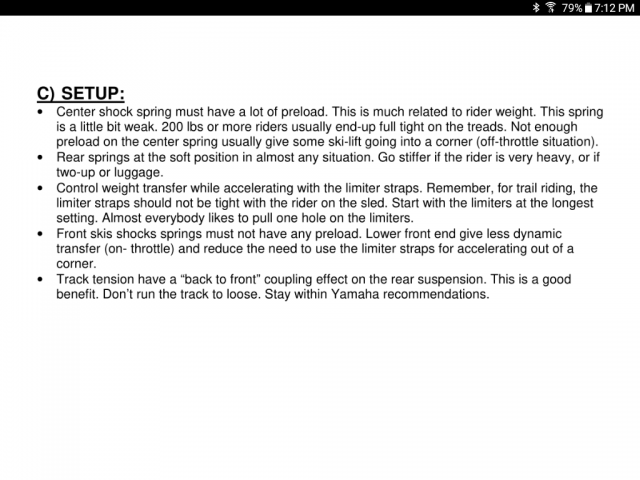

Did you get the bigger spring for the shock in the skid ?
Sledboy
Yes, At 260Lbs a must for me

Did you run it all the way tight ?

Wondering if they r talking about the stock spring in the directions .? Does anybody know ?

I believe they are referring to the stock spring. I got the replacement spring with my kit and right now it is at full preload and I'm finding it a little on the stiff side. I'm thinking about backing it off a little bit to match my riding. I stand 90% of the time so I find that my legs assist the dampening. I have only bottomed out the sled a few times in all the time I have owned it and each of those times I was sitting.
