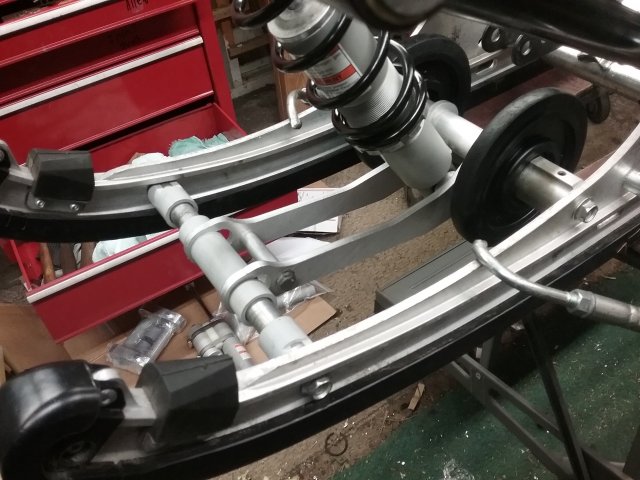

Does any body know why the front bracket on the front shock has two holes in it ? The holes that look like the number 8!

Star star star! Honestly THE best single mod I've done. Taller seat, OFT plus new split rails are all $$$ well spent but the Star is the s**t

Did you do the center spring upgrade ?

Yes at Roberts suggestion, and the shortening, as well as the revalve on both. Funny story.....when I finished, the front skis were on the doilies, and the track was flat on the garage floor, I pushed on the rear bumper, which promptly dropped 5" with almost NO effort, plus did not return up! Heart stop!
Called Robert and first thing he asked was the skis on doilies and skid flat.....completely normal.
What that highlighted to me was how soft( and turns out compliant) the rear of the skid will become after the mod. Amazing design

Did you run the spring preload all the way up ? Because it sounds like they are talking about the stock spring in the instructions. They say the spring is weak so run it all the way up, I got the aftermarket spring it's heavier. So I am not sure what to run it at

Heavier front shock spring. From Robert at Star. Mid position as far as preload. Rear torsion springs set soft

And yes rears are stockers
