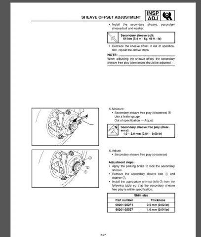

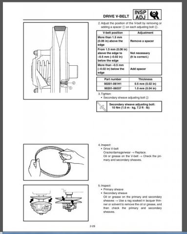

Check your clutch alignment and belt deflection. Give this engine some time to break in. It is an incredible beast.
Pete
