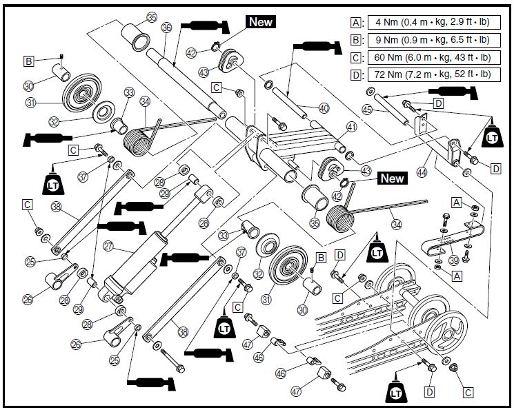

hi i am looking for the torque specs for the complete rear suspension of a 08 nytro shorty. thanks
hi fx10? standard nytro. thanks
Here you go! Hope this helps.

hi thank you very much, that is perfict, is there a site where i could have gotten this? your the bomb
Look it the Nytro Stickies. There is a whole shop manual there you can download.
EDIT: sorry, it looks like it has been taken out. Glad I downloaded it a few years ago.
