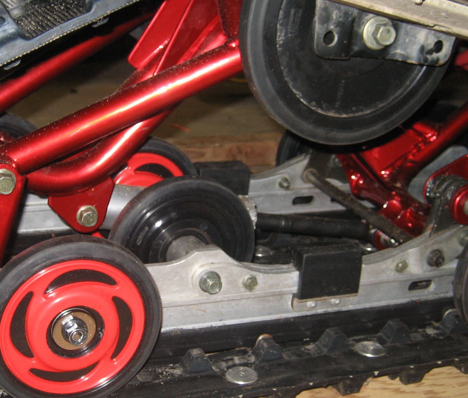

Have tried a number of ways to measure the track sag. Here is one way that I have found to be pretty relieable. I measure the distance of the track to the rubber bumpers that are about mid track, the rubber bumper have a metal bracket attached to them that I measure then down to the track, which I found to be about 2-1/4" this is good and loose without the track ratcheting. I had done this measurement on my old SXR-700R and it worked out to be the same sag, so why mess with a scale to pull 22# when a tape measure at this point is good to go. By the way I had the Yamaha dealer check it out and they said the sag was to specs so the 2-1/4" will be my benchmark. Hope this helps answer your track adjustment question.

use a fish scale 22 pound pull, set track at 1.18 to 1.38 inches, good to go
