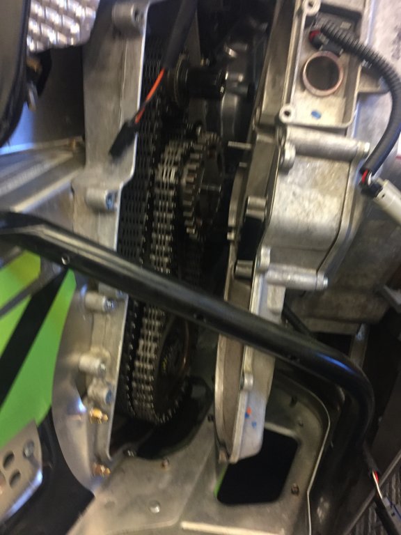

i'm thinking about buying a 137 sidewinder and want to put a corbra track under it dealer say it will take 8hours is this true. has anyone done one and how long did it take you to do it.

That is not far off. Takes me about 10-12 hours to change out all 4 bearings in the drive train and that includes removing the engine braces, upper support and removing the case. Switching tracks is about 3/4 of that as you still have to remove oil reservoir and chain case cover, all case internals, split the brake caliper, remove rotor etc. Then when going back together, you have to replace engine oil, bleed brake system etc. Now that I’ve done it a bunch, I probably could just swap tracks in 5-6 hours so the 8 hour estimate isn’t too far off.

No need to split the brake caliper or drain engine oil. 3-4 hour job at the most. You can pull the skid in 5 minutes, drop all 4 bolts and lift the rear and it comes out. These Cat skids are the easiest to put in and out I have ever seen, the 141 is better than the 137 but either way really easy. This must be a Yamaha dealer that is unfamiliar with these.

Never Satisfied is correct, no need to drain engine oil or disconnect the brake line. Takes me a little over 2 1/2 hours.
Key things are:
1 - Have a good split ring pliers
2 - Have a strap to pull the tunnel together a tiny bit
3- Start on left side first. Just seems to go easier that way.
4- Always check the shaft diameter where the brake caliper bearing is on. If you run your track loose....the diameter of the shaft is probably wore down.

Jetpilot785 how do you remove the jackshaft bearing behind the secondary ? Put it in a press ? Is the bearing pressed onto the shaft or can it be removed from shaft quite easily ? Any special tools needed.That is not far off. Takes me about 10-12 hours to change out all 4 bearings in the drive train and that includes removing the engine braces, upper support and removing the case. Switching tracks is about 3/4 of that as you still have to remove oil reservoir and chain case cover, all case internals, split the brake caliper, remove rotor etc. Then when going back together, you have to replace engine oil, bleed brake system etc. Now that I’ve done it a bunch, I probably could just swap tracks in 5-6 hours so the 8 hour estimate isn’t too far off.
Also the bearings in the case, is it best to remove and reinsert with a press or lightly drive them out and new ones back in ? Or if anybody else has some suggestions ?

As for the bearing on the J-shaft near the secondary, I usually pull the J-shaft with the bearing on. Take out the snap ring and heat the brace, the shaft will pull out with the bearing attached. Put on a new bearing, if needed, then heat the brace and shove it back in.

The jackshaft bearing on the clutch side is pressed into to brace and also onto the shaft itself. A press is recommended as heat may or may not seat it all the on the shaft or brace but also too much heat on the bearing and you risk melting the seals. As far as the case bearings, I just heat the case and smack it on a piece of wood and they fall out but same goes for installing new bearings. The bearing themselves don't have seals but there are seals directly behind each bearing that run a risk of melting, deforming or hardening from the heating process so I usually give the case a light heating to assist with the pressing process but I don't get it hot enough to where they drop right in as its too high risk to the seals. No special tools needed to remove jackshaft. Just a set of snap ring pliers is all. Its not like the viper case where it had a tapered collar to break loose before the shaft would pull out. They went to a deep groove single race bearing in the sidewinder so no need for the special collar and lock nut removal tool.
