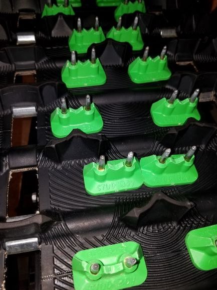

Groomed hard-pack, higher traffic = icier & harder. IMO - 1.25" Ripsaw 2 with 144 to 192 carbide studs. Probably at least 1.50" studs. I run northern WI groomed hard-pack trails w 1.25" Ripsaw 2 with 192 ea. 1.620" StudBoy Lake Racer carbide-tipped studs mounted on double StudBoy ProLite backers. Works awesome. Long, thin studs penetrate hard, icy surfaces and the ProLite backers also act as miniature paddles if there is softer surface or new snow.
