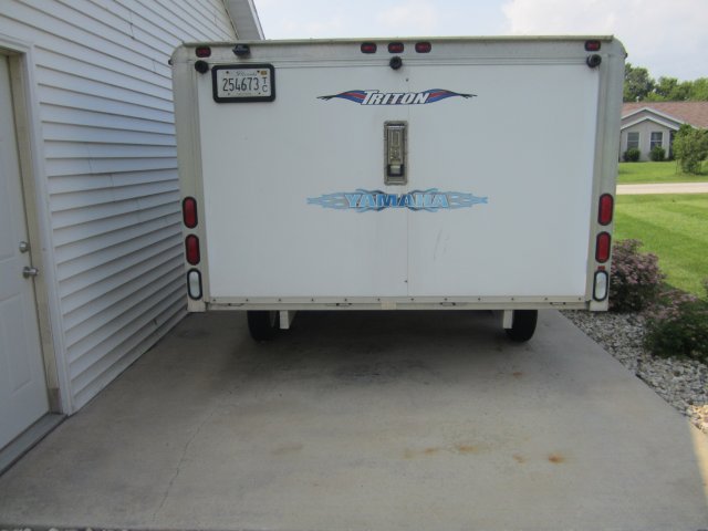

Hi Teamblue4, that's what I was thinking of. Is there enough light output to see behind the trailer?View attachment 108724 I have installed backup lights on all my trailers, I dont use LED lights, they dont get warm enough to melt the snow and road grim off of them.

alot of light, they are a very nice add on.
