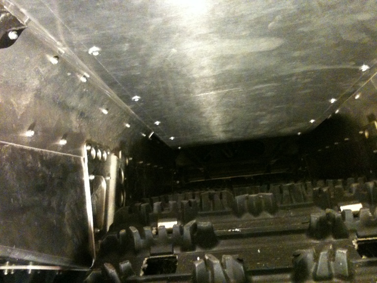

This is a picture of mine. Similar to Grizz's block off but I have the sides bent at a 45 degree. Amazing how little ice I get now.
