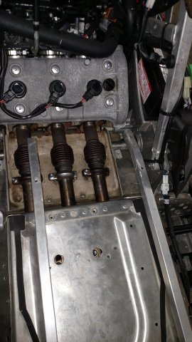

Hello I'm trying to install some tunnel. Protectors on my 13 Nytro xtx so I can stuff her I can see where the middle and back rivets install but the front ones where do they go and how do you get to it? Do I need to remove the shield under the manifolds?

its either that or you have to basically remove the track so its out of the way. working from the top is probably easier. pull the exhaust and headers, replace the exh donut gaskets while your in there if they have never been done/are wore out.

Exhaust is already pulled I just installed that header lol guess I should of kept that off too. Copper exhaust donuts already installed. Will I need to drill out and remove the cardboard looking pan under the header to get to them

the cardboard is actually a thermal fiberglass mat. yes I if the rivets are under there then it needs to be removed. not quite sure where the rivets are that hold that on though.

Well I got it wasn't easy at all lol i couldn't get the tip rivet closest to the engine but it is still very sturdy that one was impossible with out removing engine or complete skid
