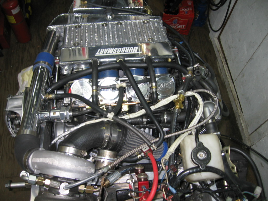

Basically, have to forget about the part going up, the manifold taper would have to go the opposite side.
than its pretty simple, a 2.5" pipe that passes between the steering rod and top of chaincase a flexible section and flange to turbo.

samrx1 said:good job ted .....![]()
check this ..after 3years ...no crack...
looks similar to ted's header in design...
like a tapered manifold, good idea!
You Build this yourself?
What is it made from?
I see the turbo is tilted to the right like Powderlites kit.
Yes, but you have to ride your sled each year to count! lol

Ted Jannetty said:samrx1 said:good job ted .....![]()
yes Ted I build myself.....home made kit...intercooler too..

ken_climb said:samrx1 said:good job ted .....![]()
hahaha you are a funny guy .. yes man trail and radar ...each years...
with the same header ......no crack..
