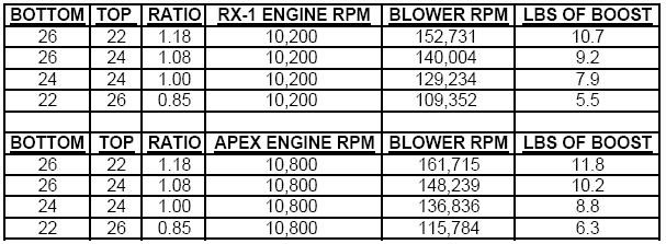

on the pulley chart(see chart below) it shows 22/26@ 11.8lbs(10,800rpms) or 24/26@10.2lbs boost(10,800)...what is the pulley setup i want?...id love to run the 22/26 for 11.8lbs,is that safe with headshim on 91 octane though?

the main reason im wondering about pulleys is this...
for two years now ive been hearing about SC setups where you can run 5lbs and then swap pulleys for radar day and run 10lbs.
now that i have this chart,it looks to me like to do these swaps,you will need the 22 and 26 pulleys.....so now i see this swap will result in 11.8boost.
so i guess im just wondering what pulley combo MPI considers their stage 1 kit@ 240hp.
Dan

just noticed that ChART shows 161,715 RPMS for blower....isnt the top limit of the stage 1 only 150,000??
can someone tell me,is that CHART possibly for a LARGER blower,like a stage 2 maybe?
i assume these type of pulley charts would be different for stage 1 VS stage 2 or 3.
Dan
Dan

Its right there 26/22 combo looks like 5 ish and 11ish for boost.
Thats the combo for radar / trail
Dan, your asking alot of the same questions over and over and most here have posted the same answers.
MPI doesn't sell their kit with any boost # in mind, that is set by you, the user. For 240 HP @ sea level you have to run the additional fuel pump and the 26/22 pulley combo.
To make it short and sweet, Figure out where you want to set it and forget it. Be that 10lbs or 5 lbs. Cause every time you change boost level, you open the door up to having to add more fuel, change clutching, possible gearing depending on how you ride. And swapping pulleys is not a 10 min job either.
You can't have you cake and eat it to.
I have tried this before on a turbo set up and popped my head gaskets. So i set my sled up to run 16 or so lbs boost clutch it for that, Map the fuel for that and let it be for the low boost settings.
That being said, From what you are telling everyone here what you want to do. This is my recommendation.
A)Set the pulleys for 10 lbs. boost. 26/24 (boost numbers will run a little higher for sea level guys, air is denser)
B)Run your head shim, with 2 factory gaskets, one on top and one under. This will lower you compression just a shade more for safety.
C)Install 10 MM ARP
D)RB3 is IMO the best out there for fueling, spend the money go to hurricane and get him to map it for you.
E)Install upgrade fuel pump, either bosch, MSD or the set up SPEED posted, all will flow enough fuel, Hurricane can hook you up with the msd as well.
F)Get any gauges you like but have boost, temp, and A/F. And watch them all very closely, all the time.
G) Ulmer Racing has great clutching for the S/C set up, Call him and he will hook you up.
H)Add additional cooling if you haven't already, all you need is the rear exchanger under the tunnel extension will be all you need.
This set up will be pump gas safe for 99% of what you will do with the sled and still be enough to make you clean your shorts every ride.
If you know you are going to go run the balls off her for more then a 1/4 or 1/2 mile races, add a few gallons of VP or A/V fuel just to be safe.
All this And we(SPEED and I) ran his S/C sled hard for 2 years with out a problem.
Hope this helps you dan, and by the way...Welcome to the boost world, it will change you!!
