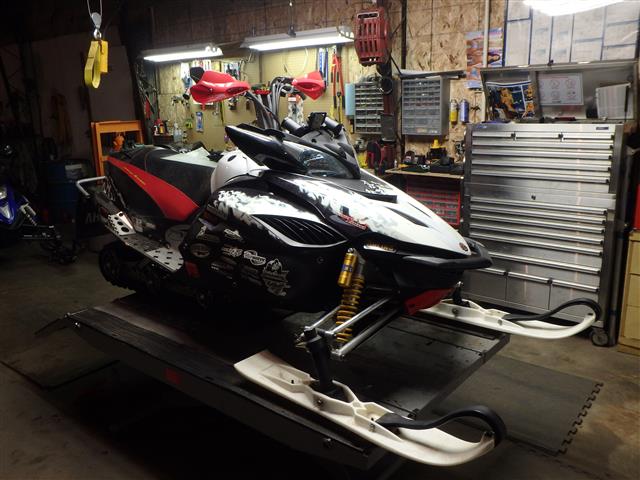

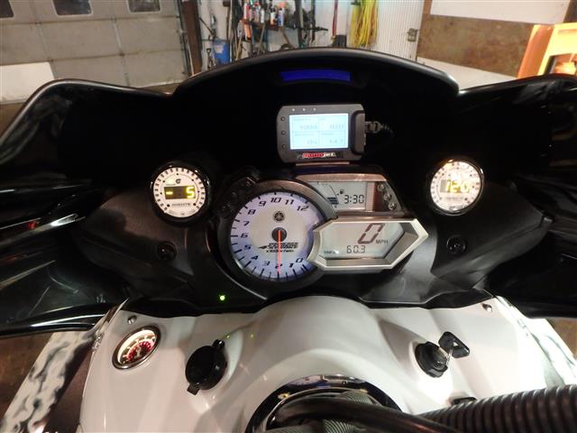

I finally think I have the PCV working well on my 2006 Supercharger. Found my oil leak. I updated to Innovate Digital Boost and Water Temp gauges and new POD 300 Digital Display for the PCV.
Here are a few pics.

I have talked to hurricane performance and they are going to set me up with what I need as fAR AS MAPPING , I like the display screen I see in your pictures will get that to then hopefully it all works good winter is almost nearing its end so work on it over the summer

Yes I like the PCV and LCD screen. I would talk with Hurricane I think they have a good map and can set you up the way you need to be.
