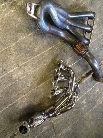

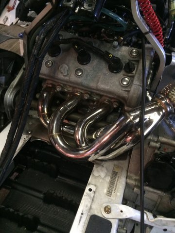

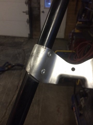

I have just installed a header from ulmer and it fit perfectly and looks great the sled has a deeper tone now. While installing it I did notice a few loose rivites and some were actually missing never installed around my heat shield which was also cracked. So if anyone has there tank off check your rivites in the tunnel around the header and the big black brace from the handlebars to the tunnel.
Pstn head
Can u post some pics with the heat shield reinstalled, if it's not too late.
Thanks
Thanks

Where were you missing rivets?

on the black brace that goes from the steering post to the tunnel and the bottom part of the heat shield that is riveted to the tunnel

Rivets missing on one side of the brace is normal, or you can't take the brace off to remove the tank.on the black brace that goes from the steering post to the tunnel and the bottom part of the heat shield that is riveted to the tunnel

Small rivnut and screw would allow removal. I haven't looked at mine yet.
