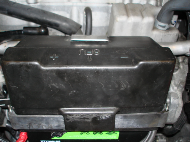

Well my OCD got the best of me again and I just couldn't have the Odyssey battery mounted backwards because of the polarity orientation. Plus the PC545 was low on CCA @ 185 so it had to go.
I considered the Deka ETX-14 which is the exact same size as the original Yuasa and which has 220 CCA which is 20 CCA more than the original but I wanted to put in the largest most powerful battery that would fit properly.
I considered the Deka ETX-20L which is larger and will fit without the foam spacers but it is only available with the L polarity which is backwards.
In the end I chose the Interstate YTX20H-BS which is the largest battery that will fit properly (6 7/8" wide x 3 7/16" thick x 6 1/8" tall) and which has 310 CCA.
As you can see in the pictures this battery is the same size as the the outside dimensions of the foam spacers. It has the correct polarity orientation and it fits perfectly with the cover on it.

Thanks for the info.Blue Dave said:Well my OCD got the best of me again and I just couldn't have the Odyssey battery mounted backwards because of the polarity orientation. Plus the PC545 was low on CCA @ 185 so it had to go.
In the end I chose the Interstate CYTX20H-BS which is the largest battery that will fit properly (6 7/8" wide x 3 7/16" thick x 6 1/8" tall) and which has 310 CCA.
The CCA's is great, which I am surprised is that high considering the size of the battery.

Yes, I was very happy to find a 310 CCA battery that fit properly. It makes me wonder why Yamaha did not put a 20 series battery in the sled for better cold temperature starting performance. I suppose it was to save a few dollars and a few pounds. The original battery was 10 pounds and the one I put in is 16 pounds. For me 6 extra pounds is worth the extra 110 CCA.

I bought the Interstate Cycle-Tron II 18AH part number CYTX20-BS. I paid $112 USD at my local Interstate battery store.
It weighs 16 pounds compared to 10 pounds for the original battery. For me 6 pounds of extra weight was a fair trade for 110 CCA of extra power.
Other companies offer a 20 series battery (which is the largest battery that will fit properly at 6 7/8" wide x 3 7/16" thick x 6 1/8" tall). I went with Interstate because I have had such good luck with their batteries in my boat.
Just make sure that you buy an AGM type battery and do not buy a 20L as the polarity orientation will be backwards.
