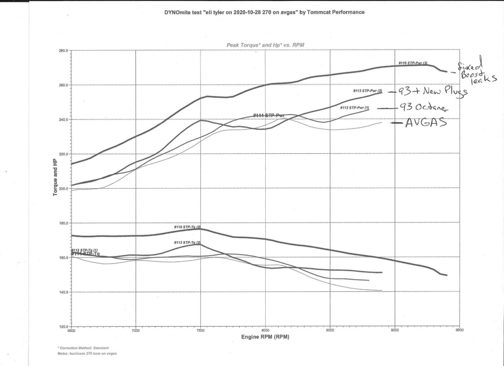

I'll listen to Tommcat since he actually dynoed the Av-Gas on the 998 thanks...
As you can see below from the graphs, the engine will run yes, It just does not make the kind of power pump fuel does on the Hurricane 270 tune. It's clearly down on power by a good margin.
Tommcat shares good stuff on his Facebook page and I really wish he was here on TY. I understand why he is not however.
Tommcat Performance
October 28, 2020 ·https://www.facebook.com/tommcatperformance#
I have said multiple times that we would get around to comparing Avgas to pump fuel on the dyno, and we finally found a reason to do so.
Here is a comparison on a Sidewinder with a basic tune, with avgas vs 93 octane, 10% ethanol pump gas. No other changes were made, strictly the fuel swap.
Bottom line is avgas, top line is pump gas.
Tommcat Performance
October 29, 2020 ·https://www.facebook.com/tommcatperformance/posts/2025197307671662?__cft__[0]=AZXI913yJiNtC7jPZK8Kvfc259YOkLeYXBg8vA-ZkSxf89iVB3Z_e70CUOVcFifsxROP-ON453S34jJHL2DU4wLF0hQcQ001GYoBRwemmqlTPlpNA3yirmsSmtUxtBKSkuQ&__tn__=,O,P-R
same session we tested the avgas on, just with more issues fixed along the way. it was a long day.
bottom line is with the avgas, next up is strictly a switch to pump gas, as seen on the previous post.
next line up was changing spark plugs. we removed CR9E that were damaged, from what i believe was when someone gapped them and damaged the center electrodes on 2 plugs. we installed our preferred CR9EIX gapped at .030
final line is after fixing multiple boost leaks.
these are all on a Hurricane 270 tune
Tommcat Performance
October 28, 2020 ·
Tommcat Performance
October 29, 2020 ·
I suspect a couple reasons the AV gas was down on power were:
-the engine with the Hurricane tune only requires 93 Octane ,or less, to run properly and safely . 100LL Av gas is highly refined ,controlled , has an absolute minimum of 100 octane, and can be as high as 110 octane. It has been reported and proven for years that using fuel with higher octane then you require for you particular engine will always make less power. I think Tomcat has just proven this theory. I suspect that VP C12 would have given similar results to the 100LL AV gas's hp output.
-93 Octane pump fuel is oxygenated to some degree so it is contributing to good hp numbers.
Now if the boost levels of a particular engine required 100 octane to perform properly the 100LL or VP C12 would perform well.

Really the point here is if your motor was tuned around 91 , 100 Octane fuel is a waste of money and loss of power.

If i had to i would personally mix a quality fuel with pump fuel instead without hesitationInteresting read thanks for sharing.
What is your experience with octane boosters vs mixing straight up race gas?
