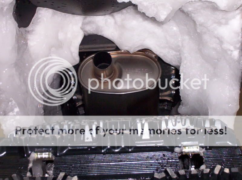

Bugbear
Here's mine after a 52 mile ride.

Nice Pics Bugbear, looks just like the rest of our sleds.
Wow those rubber flaps really enhance the look and I bet the performance of the Multi Purpose sleds. Looks like they do a great job preventing ice buildup.
This must have been a Jr. Engineer project.
If this is the improvement Yamaha has made between '07 and '08 models I can't wait to see what '09 brings.

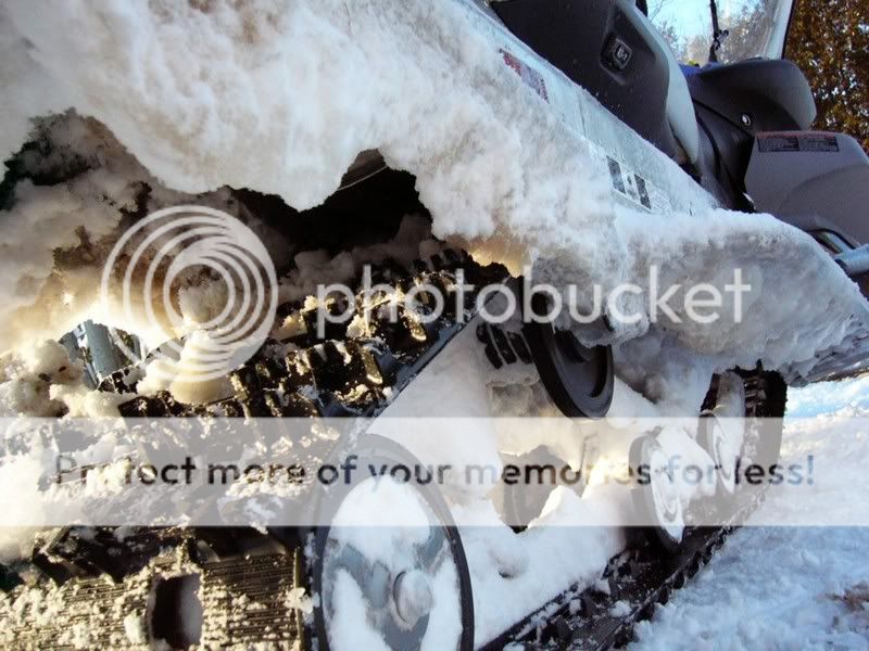

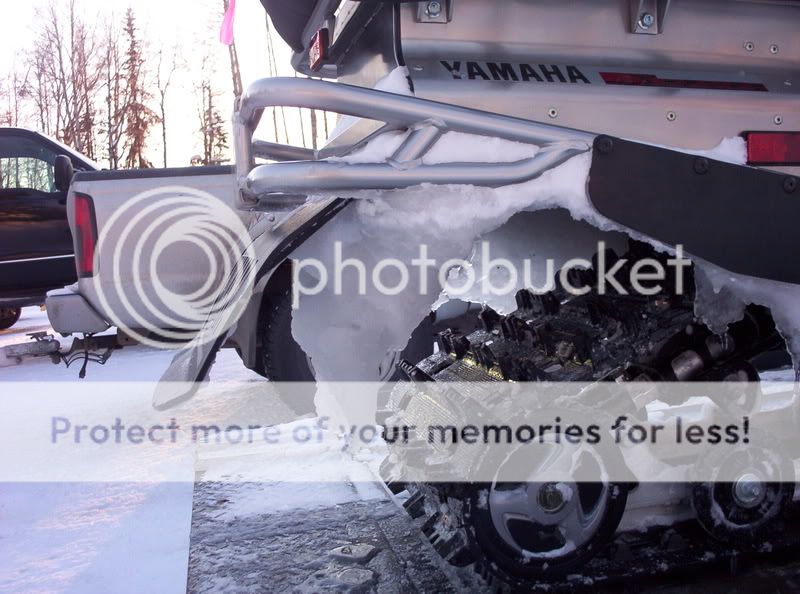

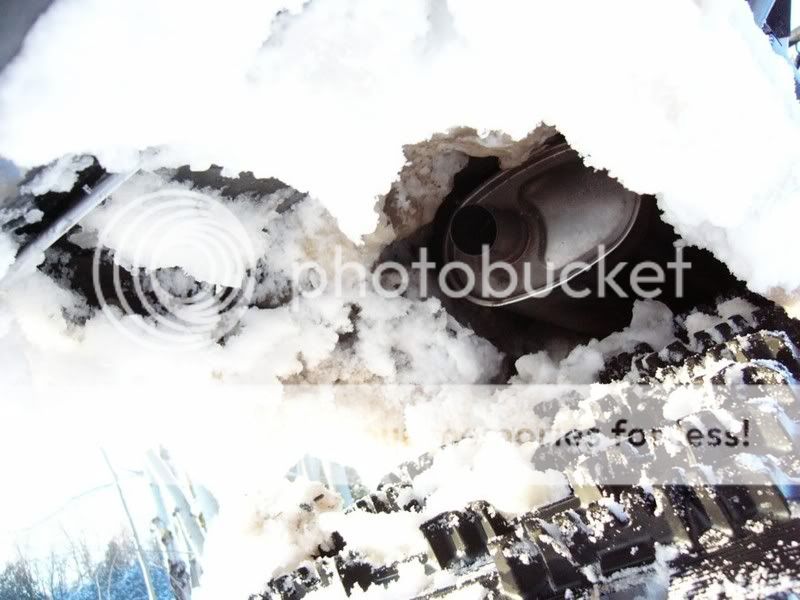

Zare
Well after a 150klm ride today i have an extra 40+lbs on my sled...
and i had to include this one..

SNOBLOWR
Welcome Zare, your VL looks similar to the rest of our sleds.
