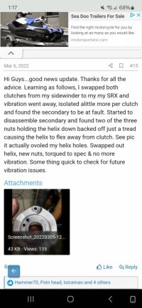

I'd say theres a possibility it will simmer down a little after the break in period. Which is 300 miles. I also found this from another thread. Might be worth a look as well. I got a brand new xtx 0 miles i can check in the morning to see if it has a lot of vibration while on the stand best i can do with no snow.

Only time any of my 998 powered sleds vibrated was with a cracked stub shaft, throwing the primary clutch out of balance.
