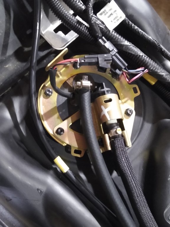

GSS342 upgrade & return line complete. That went extremely well

Looks goodGSS342 upgrade & return line complete. That went extremely well

Honestly it went flawless. I did ruin that flexible fuel line that comes out of the pump. And had to replace it. And obviously I didn't have it sitting there... So took two extra days.Looks good
