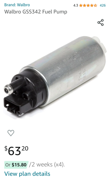

I clicked on the 12% of reviews that rated it a 1. That made up for 68 total votes and 60 of them were written reviews stating the pump lasted anywhere from minutes to weeks, some for months. I wouldn't touch this one, why go through the effort to save a few bucks? Even if you got lucky and it lasted I would always be wondering when it was going to quit in one of those situations when it's late in the day, getting dark and you're trying to get back to the camp. What about if it quits and your @ 133mph? It's just not an area to skimp. Take advantage of the DIY stuff, but still by the top notch equipment.Fatchance, a daunting task to be sure. I found this number on Amazon and then read reviews. Most reviews are positive and claims of it being the real deal. But you know how it goes, always one in the bunch, complaining about this or that.
Side note: I've been researching this for a week or so, even Mike at TD gave it his blessings. (Not source, pump) This pump can go in and run pump gas with great success. New relay harness & return to slipper as well.

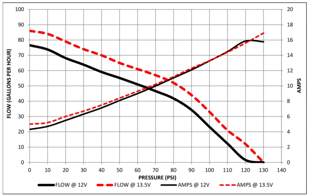

All pumps of this type are lossy in operation so you care about pressure@volume. They chose the same colors for flow and current draw but the thick version of black and red are what you care about. At higher pressures, there is a lot less flow available and vice versa.
Universal In-tank Fuel Pumps

I upgraded to the walbro 190lpm for my max spool17 tune. Bought it for amazon for $79. The pump seems to be authentic to me. Haven’t had any problems with it.
Also bought the fuel pump bosh relay and harness plugs and made my own pump relay harness to power directly to battery. That was about $40 in parts

At 20 psi boost you need 43 + 20 = 63 psi. The chart shows somewhere between 55 - 60 gph output. Again, way way more than MS20 tune needs.All pumps of this type are lossy in operation so you care about pressure@volume. They chose the same colors for flow and current draw but the thick version of black and red are what you care about. At higher pressures, there is a lot less flow available and vice versa.
walbrofuelpumps.com
Agree w NYTurbo, GSS342 is good for at least 500 HP, probably more.

Surprised there's that much difference between 12 volts and 13.7.All pumps of this type are lossy in operation so you care about pressure@volume. They chose the same colors for flow and current draw but the thick version of black and red are what you care about. At higher pressures, there is a lot less flow available
