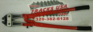

The answer I was afraid of.. Is there something special for cutting the holes? ... Also clipping is going to be a bitch, because its going to be 2x the clips. 2 clips for each new hole.
sleddingfarmer
Not sure on the best way to cut the track. A sharp knife I guess.
I've never had to clip a track, but I have a couple friends who have done it and they weren't very happy about it. I believe they used the small tool. I think the larger tool would make the job significantly easier
