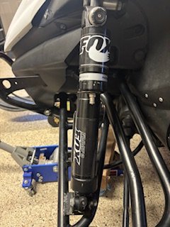

Can someone please tell me the exact model of these floats I have searched high and low and can’t find this exact model anywhere. All the pictures and models I have found vary in one way or another.
They say float 3 on the body.
Performance series on the piggy back
Decal missing off the evol chamber?
The piggy back has an air valve but this is nitrogen chamber isn’t it or am I mistaken?

I have never had these shocks but as far as I know the air valve is so you can adjust your PSI to how you like—- should have came with an air pump…..

Canister on the “top” of the shock is indeed a remote reservoir where the nitrogen chamber will be located. The smaller chamber on the bottom is an evol chamber for added air volume. In terms of which “model” these are I have no idea, I’m not an air shock or a Fox guy for that matter. @cannondale27 might know exactly what these are, he services a ton of shocks in the off-season.
Yeah that’s nitrogen! It’s Float Evol RC2 if it has rebound. Awesome shock! I run 110psi Evol,70Main air pressure 11 clicks out rebound and 10 Compression low speed adjuster. The Nitrogen is 250psi.
