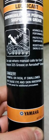

Rich your right all good choices-BUT
LMAO- waterproof grease, I must be a dumb *** cause I thought any grease was waterproof.
When researching the best grease years ago the first thing that came in mind for my sled was a grease that would fight snow. The best synthetic greases on the market have been tested so it was easy to compare. Lots of test procedure for Operating temp, Four ball wear test but the test that stick out for me for snowmobile was Water washout test. Of all the greased I compared, that was available to me, the Amsoil Synthetic Water Resistant Grease had the better numbers.
The funny part is I already had a tube, since that is what I was using for my boats sterndrive. So no need to buy a second grease gun. Bonus. Grease is Yamaha Blue, double bonus.

You can but I would recommend a wheel bearing grease. Preferably synthetic.Can I use Yamaha suspension grease for jackshaft Bearings?
