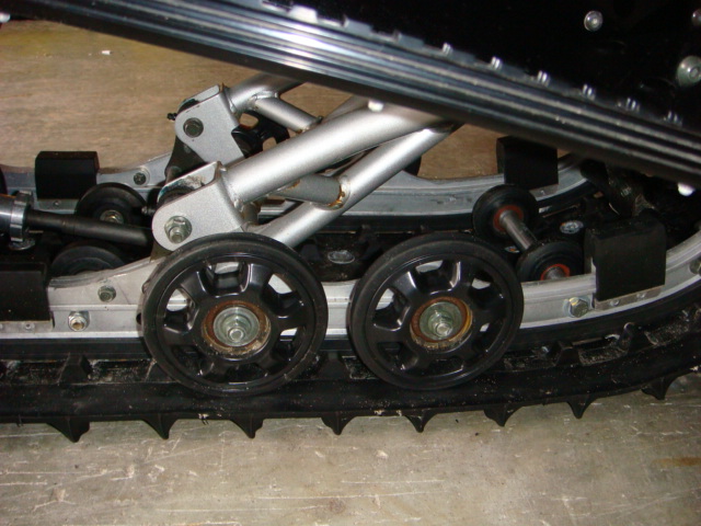

Anyone know where I can purchase slightly oversized idler wheels for APEX GT for the stock 5 Inch ones which have the unreplaceable bearings.
Had purchased some in 2007 from Rich Motor Sports but can't seem to get ahold of him. Slides were toasted near the 2 inside rear idlers in 650 miles on recent Quebec trip and my 06 Apex GT had hardly any wear with the slightly oversizes idler wheels I purchased from Rich. last year.
wheels
Any polaris 5.350 wheel, you can also buy them through kimpex or motovan or royal distributing in canada. Use an extra washer between the wheel and the stock washer to take the extra space. I have been running them on my last 5 four stroke sleds.
the best setup IMO for the MONO skid is this...
-FIX Pwersports FRONT wheel kit
-FIX Powersports MID wheel kit
replace junk stock idler wheels with yammie accessorie wheels(spoked)..ive got over 3500 miles on my spoked wheels with no signs of wear...and they have replaceable bearings.
you should then get thousands of miles out of sliders....the fix wheel kits save sliders in the two hi wear areas.
dan
