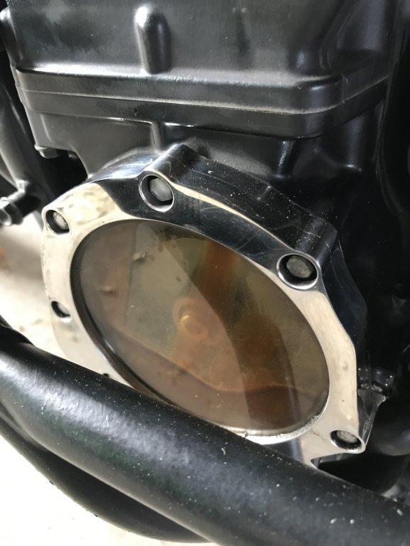

My bike is stored in the 50* cellar & has a clear lexan pulsar engine cover, you can see the white milky film the old oil is collecting, wouldn't wanna run that for the season. Done it that way for all 65k on it.

That is interesting with the clear cover you can actually see the condensation as it happens over the summer... tough call then as my logic has been most of the condensation / moisture would be happening during the season, running the engine, hot, cold, etc so end of year in spring draining and refilling fresh would get all that out before storing it. Now if more is getting in during the summer six of one, half a dozen of another... do you let it sit all summer, change in fall so moisture free to start, may be better. I didnt change last spring as it was new to me so I am changing the oil this coming week so lets see what is inside from summer storage...

That's old Summer oil, probably 3500-4000 miles on it.

Makes sense now that you are seeing moisture in used oil with 3500+ on it... everyone makes their own decisions but I still stand by the idea of changing the oil in any engine or gear case (sled, boat, lawn mower, etc) when you put it away after using it for a season, never store anything with old oil inside my Father used to say. Many good articles on the why's, below is a quote from one I found.
" ... If you own a 4 stroke motor, change the crankcase oil and filter at this time. Moisture and acids in old oil will pit bearings and other engine parts while in storage, so you need to drain it. First warm up the engine so more of the dirty oil will drain out and impurities will flush out more easily.... "
