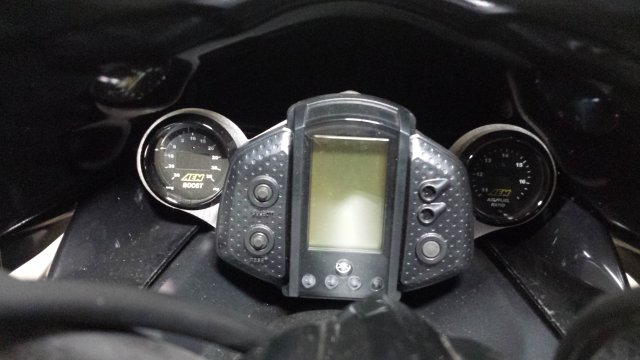

NeverEnuf
I went with the digital aem boost gauge and aem a\f. Mounted the gauges by the stock gauge. I welded the bung on the intercooler for my pressure sensor.

I went with the digital aem boost gauge and aem a\f. Mounted the gauges by the stock gauge. I welded the bung on the intercooler for my pressure sensor. View attachment 104452
Your install is really nice. I thought that it may break stuff when rolling over.
