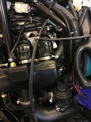

so how much vacuum are you guys seeing?

Hi beerman,when my koso gauge comes in next week,we will install both boost line and a/f into exhaust bung,and maybe a line to intercooler,as that gauge has three different set ups,but the line for vacume/boost is the area where in this pic,you have it teeded off,correct?Ok, sensor works for both negative and positive pressure (used my mouth). Can feel vacuum is pulling from line where I tapped in. I'm stumped.
Would also like to know this?

I tapped into the same hose as most did on here, the main hose spanning nose to throttle body... seeing more boost on my gauge that I should be running. are we sure we’ve located the optimal spot for accurate reading? I know my evo stage 4 isn’t running 16lbs at 3/4 throttle

My koso gauge is also reading to much boost.I tapped into the same hose as most did on here, the main hose spanning nose to throttle body... seeing more boost on my gauge that I should be running. are we sure we’ve located the optimal spot for accurate reading? I know my evo stage 4 isn’t running 16lbs at 3/4 throttle

No it sure is not,i have same tune,and NOS-PRO does to,and he has the Koso x-2 guage,but he did say it reads 16 for max boost and not 14.9 or 15,but he stated it may be from to strong signal, and may need to reduce that signal down some.I tapped into the same hose as most did on here, the main hose spanning nose to throttle body... seeing more boost on my gauge that I should be running. are we sure we’ve located the optimal spot for accurate reading? I know my evo stage 4 isn’t running 16lbs at 3/4 throttle
