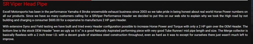

Spend your money on something other than a header....
http://www.excellmotorsports.com/SR-Viper-Header--viperheader
I think this is worth a cut and past:

I disagree for a couple reasons. First, other manufacturers have found power in headers. On their own they are worth a few HP, when coupled with supporting mods the gains increase even more....I went through this on the Nytro.
Secondly, Excells design was a shorty header, which are great on boosted applications, but long tube designs work better on NA applications, especially with supporting mods. It's the same in the automotive world. SPI have had great success with their header on both turbo and NA, EVO has been popular and offer a similar to stock design using larger primaries. Hindle used tuned lengths that are longer because in their many years of experience building exhausts, that's what they've found to work. Hurricane used the same recipe as he did with the Nytro and came up with near identical results....a proven combo IMO. Plus you can buy his entire kit for $1200 US...great deal.
I think by posting what you did Grizz, you have discounted the other manufacturers that have found power in a header, based on one design that didn't work out. Again IMO, when doing NA mods, do them all together as that's where you will get the best results.

I haven't discounted any manufacture. Excell is stating (not me) that they believe the Viper's OEM head pipe on the stock NA engine offers adequate performance. Regardless of what others claim, Excell did extensive testing and decided that the OEM pipe wasn't all that bad so they elected not to push a product that they couldn't improve enough to make a difference. The statement was copied from their web site which hibshaman25 posted the link to.
Excell has a good reputation and I commend them for reaching out and keeping their customers informed.
