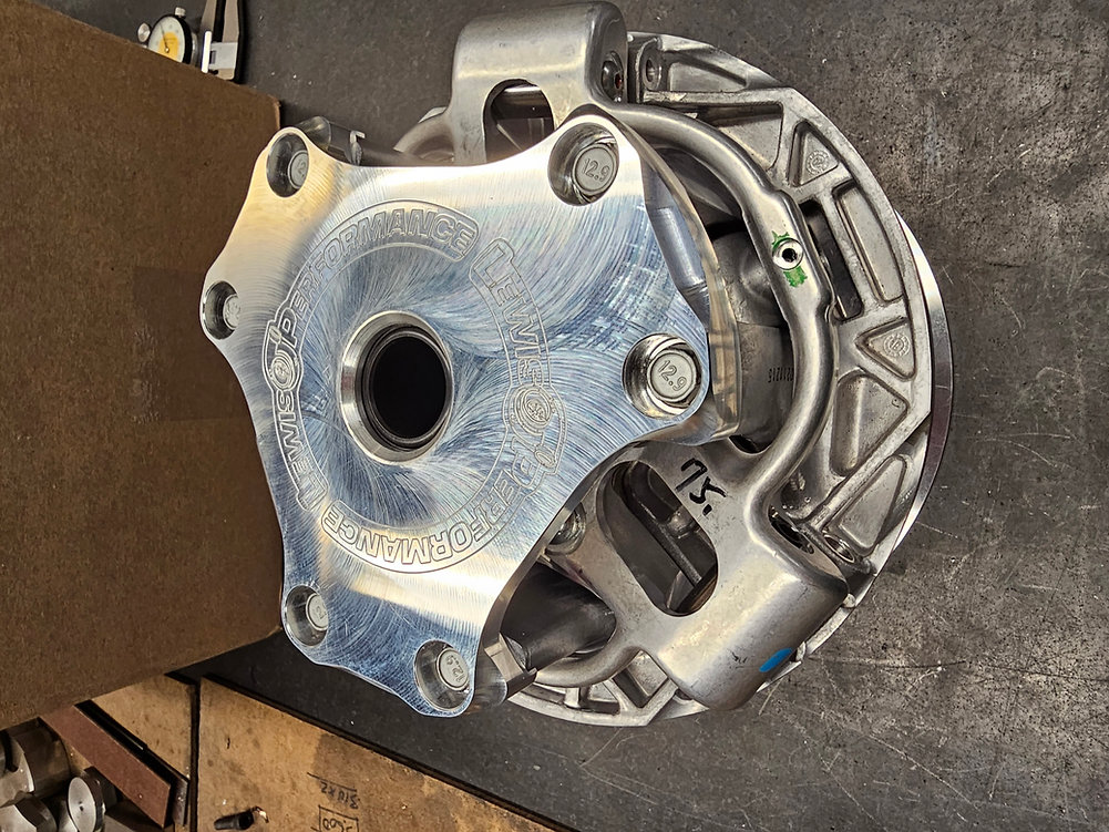

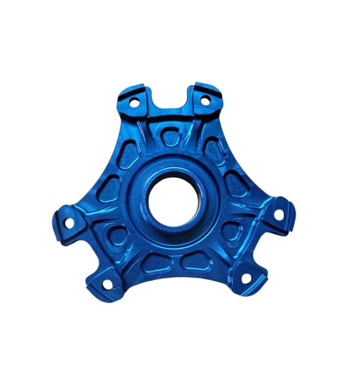

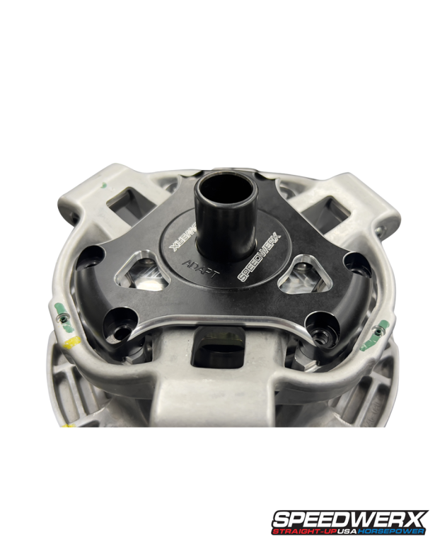

I have been looking at covers. I don't see any that actually "capture" the towers as I would call it. they all seem to have bit of the tower hanging out of the cover.Cat newest version, Precision EFI, SSI, Bikeman all sell a reinforced stronger ADAPT cover that captures the towers.
maybe the Tricked Toys( Lewis Performance) cover comes the closest?
This cover looks as though it may actually wrap around the towers.

Lewis one is what you want. Some of these companies are already on revision 2, 3, etc. The SSI one I have is made like that Lewis one, captures towers so they don't flex.

So it is not like what is shown above?The SSI one I have is made like that Lewis one, captures towers so they don't flex.
Turboflash
- Mar 18, 2019
- 2,813
- 2,844
- 1,113
- Southern MN
No. It wraps around end like Lewis one. I bought it maybe 2+ years ago. They must have changed it for some reason.So it is not like what is shown above?
