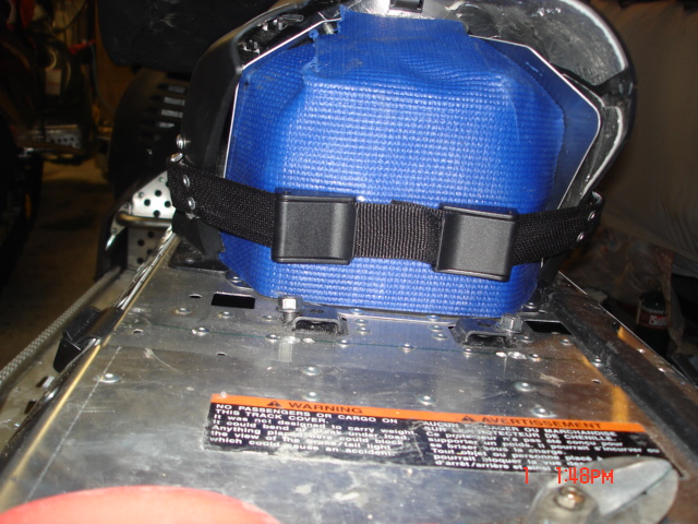

Using one off a Kawasaki ZX 10. The price was right. Friend of mine scored a couple of take offs from the dealer. Was a little worried about the outlet size as it smaller than I would have liked, but with some clutching and gearing to match the CE I am getting great mileage and hitting rpm fine. I changed the angle of the outlet and last week end a whole lot less ice build up.
BombaPolaYama
swelly said:Using one off a Kawasaki ZX 10. The price was right. Friend of mine scored a couple of take offs from the dealer. Was a little worried about the outlet size as it smaller than I would have liked, but with some clutching and gearing to match the CE I am getting great mileage and hitting rpm fine. I changed the angle of the outlet and last week end a whole lot less ice build up.
Would you mind explaining with some pics as well?
