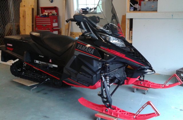

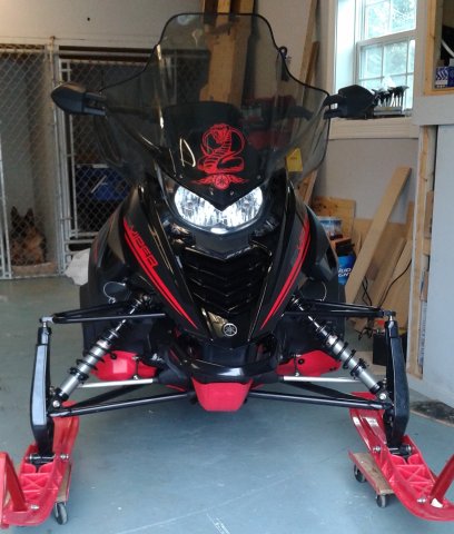

Got sled all put together. Added a red skid, skis, decals and strips. So it look a lot different that stock.
One pictures of sled before crash and 3 pictures after the crash with the repairs complete.

Nice job. Looks sweet. Good luck with it.
Sent from my SM-T817R4 using Tapatalk
Yes! Looks better than new. Very sharp.
