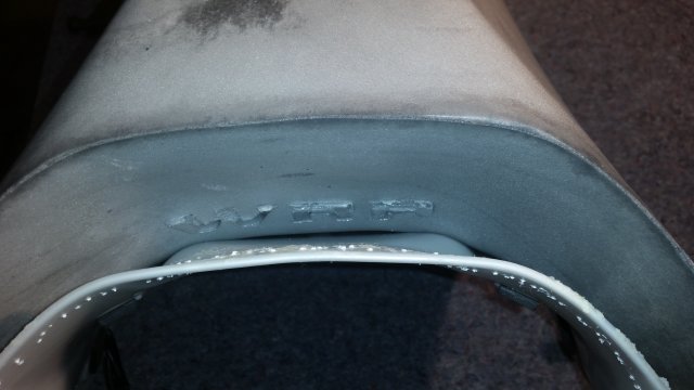

Here is the stock seat and what the bottom of the seat pan looks like:

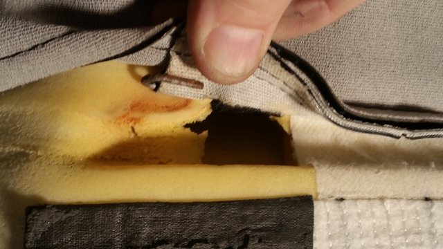

This is where I made my first and only (at least to me) mistake. The WRP directions said to use spray adhesive on the seat foam and pan. Me being me, I bought the best 'professional grade" adhesive money could buy (at Menards anyway). I have now dubbed it "Nuclear Fusion" adhesive because holy sheet does it stick FAST. When the can said "no repositioning after sticking the two surfaces together"....they weren't kidding! I also used wayyyy too much adhesive. I sprayed every surfacr on the pan and accordking to the instructions on the can, sprayed several layers on the foam.
I could have used 2 people here...one holding the back and one the front. But it was only me and I started in the rear..then the sides....then the front. I was off a bit in the front and tore the side foam (pictured) trying to reposition it. Not going to happen! It's within a 1/4" and you can't see it or feel that it's off.
The foam in the front of the seat did stick down nicely to the pan. I didn't take a picture of it.
