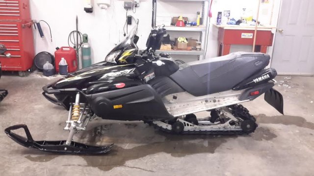

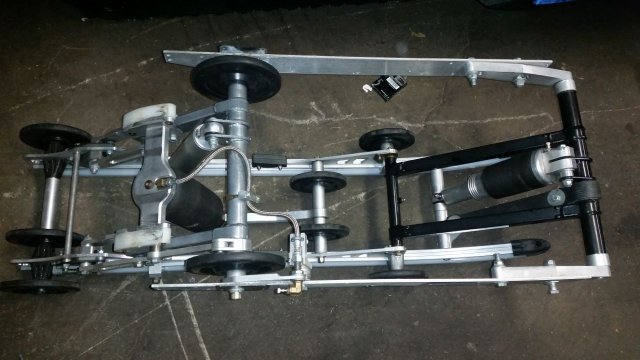

That looks awesome !! What is that rear suspension ? Looks like it rides pretty sweet.
Looks like an M10.

Its an m20 airwave suspension from team fast. Smooth ride, nothing compares,period.That looks awesome !! What is that rear suspension ? Looks like it rides pretty sweet.

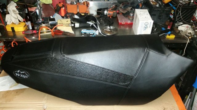

Sweet! Did you need cable or brake or wire extensions? ThanksView attachment 114816 my wrp seat instaled. I love this seat. no more knee and leg pain. best mod ever. 3 1/2" pivot riser is perfect for me, 6ft 5 inches 300 lbs.

yes i added a powermadd throttle cable extension kit for yamaha. rerouted the rest.

I must say not only does the seat look fantastic... but it makes it feel like your sitting on a new sled

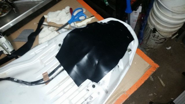

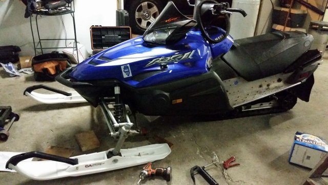

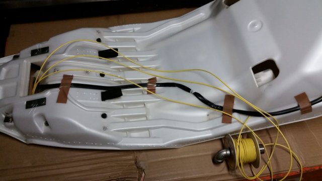

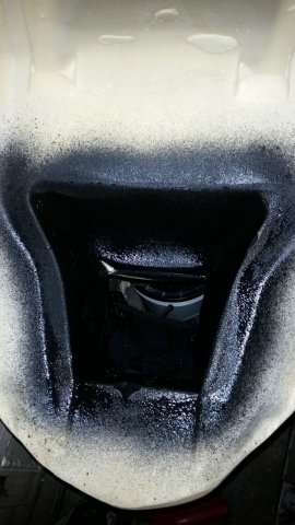

!!! Here are some pictures of the before and after. I removed all the staples and sanded the old holes to where the plastic was smooth. I ran a new set of 14gauge wire next to the original wire harness just encase it was ever needed, i figured this was a good time to do it. I also included images of what i did for the trunk space, you will notice it is all black. I used a flexible rubber sealer for the seat itself and cut out a section of the old seat and just stapled it on the back end. Now i just need to install this M20 Airwave i just recently scooped up
... It will be my first time removing a skid hopefully the install isn't to difficult

I must say not only does the seat look fantastic... but it makes it feel like your sitting on a new sled!!! Here are some pictures of the before and after. I removed all the staples and sanded the old holes to where the plastic was smooth. I ran a new set of 14gauge wire next to the original wire harness just encase it was ever needed, i figured this was a good time to do it. I also included images of what i did for the trunk space, you will notice it is all black. I used a flexible rubber sealer for the seat itself and cut out a section of the old seat and just stapled it on the back end. Now i just need to install this M20 Airwave i just recently scooped up
View attachment 123810 View attachment 123811 View attachment 123812 View attachment 123815 View attachment 123818 View attachment 123813 View attachment 123819 View attachment 123820 View attachment 123821 View attachment 123822 View attachment 123823

You can buy a "Seat Jack Passenger Seat Kit" Dennis Kirk has them. However, they are about $500. I wouldn't recommend using your RX1 as a 2-up or at least not exceeding 400lbs on that sled. As for the seat itself, if you had too, two people can fit on it and be more comfortable than the stock seat without a doubt. Here is what the foam looks like.. Its super thick compared to the stock seat!Newbie here so this may be a dumb question.
