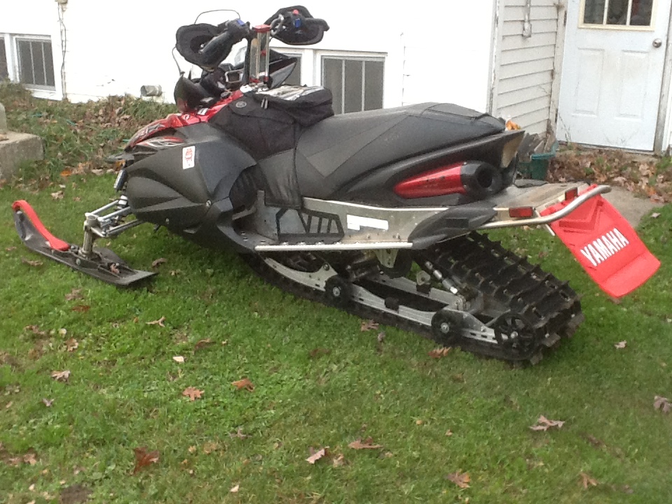

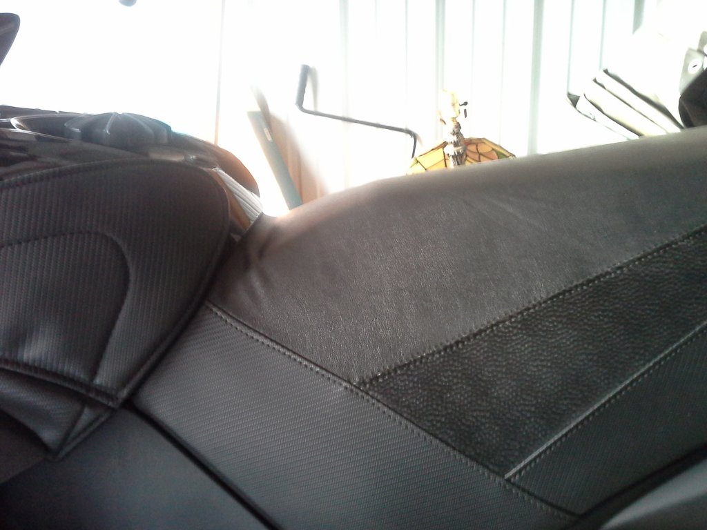

I put a WRP seat and 2 in riser on my '12 XTX last season. Just put sled in storage but will get some pics for you. I am a very tall guy, best money I spent on the sled. It did change handling by changing my riding position, front end pushed bad from the change. Pulled front limiter strap down 1 hole and played a little with spring tension in front shock of rear suspension and problem solved. I think the foam issue on their seat was a short lived mistake. I am slightly over 300 geared up and didn't feel seat foam was too soft.

Thanks for the pictures. The close up picture of the tank seat intersect is what I was most curios about. With the WRP seat do you find yourself sliding forward like OEM one.

For me, I do not slide forward but I am almost 7 foot tall, so my legs naturally keep me a little ways back. This said, I don't sit back much farther than where the hump begins. I also don't think the wrinkles toward the front of my seat are normal, more due to my weight and where I ride on the seat. As said earlier, great upgrade. Not quite as good of a seat position for me versus sidewinder, but close enough that I'll keep the cash for now and continue to enjoy my EPS.

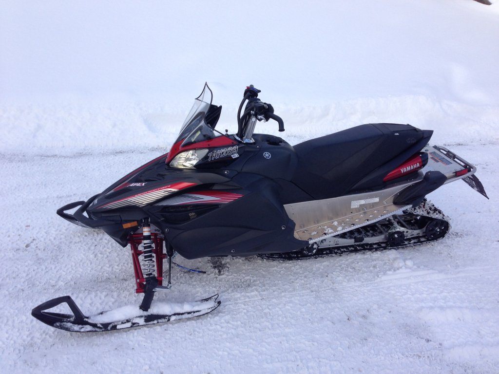

My 2015 XTX LE , has the UN riser and the WRP seat .Thanks guys that exactly what I was looking for.
Sent from my SM-T817R4 using Tapatalk
I am 6'2" and this set up is great !
Also have the Star kit , 13mm sway bar , hyfax savers , duponts,snowtrackers, Tric ice scratchers,and heavy front skid spring .
I think this combination of upgrades make a very good sled better .
