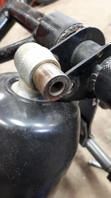

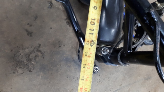

Working on my 2015 viper xtx trying to lighten up the front steering yet. I put bill mohrs spring in and tightened it up quite a bit but it still steered quite heavy. I was looking at it trying to figure it out and I found a couple things that I’m questioning a bit. The front shock seems to short. When you lift it up off the ground it’s hanging on the shock piston rod rather then the limiter straps. The top bushing is also a odd ball size. The bushing that’s there is very loose in the shock eyelet. Couple numbers on the shock body but they didn’t mean to much from what I could find on a quick google search. Anyone have theres out or have some measurements on them? Overall length on mine from end to end is about 12 and 11/16”.

Should there be two bushings in the upper shock eyelet? One that goes on the bolt and one nylon that is pressed into the upper shock eyelet? I just have the one steel bushing that fits very loose in the shock. The bottom has a nylon or similar material. And a nice fitting bushing that goes all the way thru.
Sounds like there's something not right in the top eyelet. Mine had a bushing between the eyelet and the bolt but it's a nice fit. They look like there's a bronze liner pressed into the eyelet. You should have a shock tech look at it, but like I said, they are cheap to replace. Mine from Cat was $137.95 CAD. That's the shock, not including the spring.

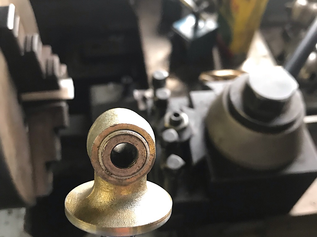

I can turn one out of Teflon or possibly brass if I have some leftover stock kicking around for the time being but it would sure be nice to sort out the rest of it it too.
19 appears to be the same pin/collar/bushing or what ever you would like to call it that goes over the bolt. They don’t show a separate bushing available for the upper eyelet other then 19. Google search of the part number didn’t show me a picture of it either unfortunatley.

Not sure if you can buy the bushing alone. You could maybe get away with brass if lubed up good but I wouldn't expect a long life.

I have my skid out and shock measures same as yours and 1 thick wall bushing in top eyelet.

Awesome thank you for doing that. That bushing is certainly larger then mine. I made and pressed a new bushing into the shock eyelet that takes up the slop. It’s just Teflon shafting but it’s beyter then having it loose.

You could try the front track shock out of a 2016 xtx. It's about 3/4" longer. I made this switch last year trying the same as you to lighten up steering. I run aggressive snowtrackers so I've got a lot of bite. I had switched to the 160# spring and the shock relocate and ended up breaking my front swing arm because of the shock relocate. I then discovered the longer 2016 shock. The nice thing about the longer 2016 shock is it allows you to run limiter straps all the way out without any slack in them. I couldn't do this with 2014 shock. The only downside to this setup is it doesn't like really deep powder which we almost never have in central Minnesota. You'll get more vibration in deep snow when that front shock is fully extended.

I have run into that also. The number on shock says its for a XTX but the shock is RTX length. I do not know if it was a error on Cats part or just the way it is but you did the right thing ensuring the Limiters do the limiting and not the shock. Shock will be ripped apart if limiters are not doing the limiting. When I informed customer about it he said the sled handled way better and still had plenty of Transfer for OffTrail with limiters pulled tight enough to limit shock travel. I believe he said 3rd hole but dont hold me to this. Maybe they did that for better approach angle? On any sled always put limiter bolts in last and ensure the arm is being slightly compressed when straps are fully extended.

It will. Maybe the straps are just longer. A LTX shock is about 1/4in longer than yours and I have a spare here with stock valving. $50
