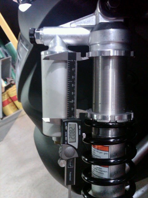

Here are my settings for the XTX with the Star Suspension installed.

Spring Preload (Measued between the locknuts) 2.8" as per photo

Spring Preload Length (Measured length of spring w/ rear of sled off the ground) 1.62" of thread exposed as per photo

Comments The center shock preload really changes the pressure on front skis. Using this set-up with the Split rails, the steering is not heavy at all. Increasing Preload beyond caused the front end to float during transfer.
