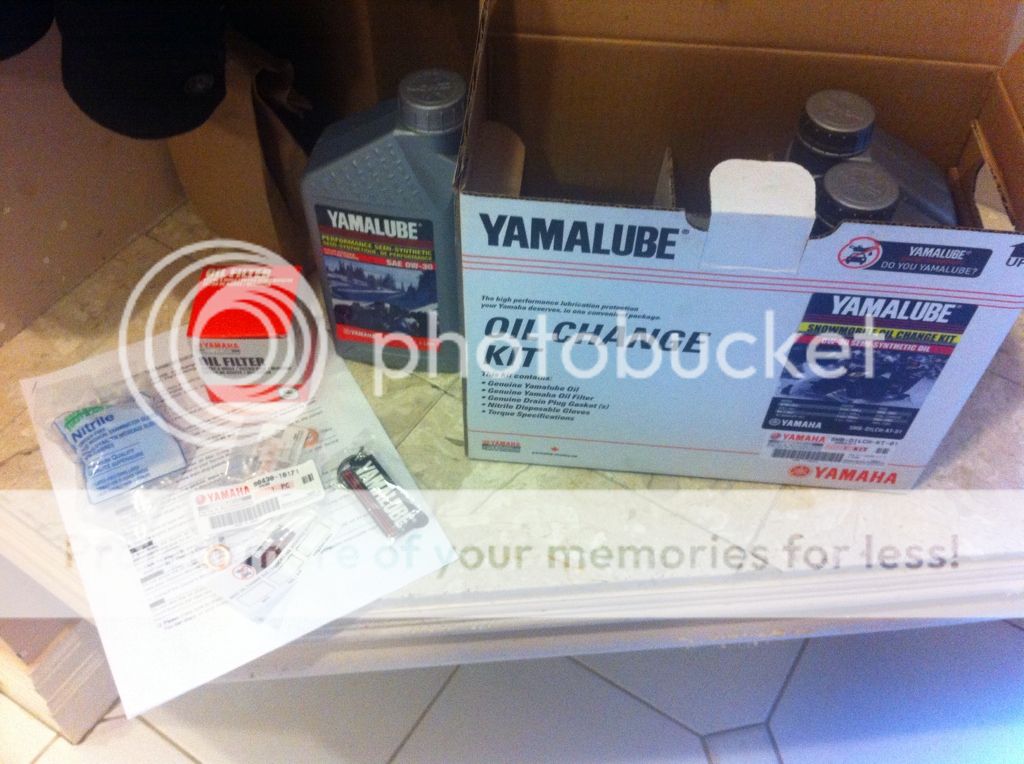

It's actually a really nice kit, comes with everything. This kits was for the apex and was $59.95 CND and came with, 3 liters of oil, filter, two gaskets , gloves, key chain , oil change reminder sticker, and 4 pg. of instructions. My oil change kit for my Polaris RzR came only with oil and filter'. Really nice job Yamaha ;)! I did consider Mobile 1, 0W20 but only for that extra performace....But I never considered using anything other than a Yamaha Oil Filter...

That is a nice kit, and I'm glad to see they have lowered the prices some, but keep in mind that is Semi Syn oil, not full synthetic.

4 pages of instructions eh - must be quite the process. Don't suppose you would mind posting the instruction sheets here? As for the gaskets - I guess Yamaha recommends changing them also - how many guys do that? So one gasket for the drain plug and what is the second one for? I'm also wondering why Yamaha uses semi-synthetic oil rather than full synthetic?

Sorry I threw out the instuctions, IMO the owners manual was better anyways....for example..the instuctions says nothing about starting the sled after 2 liters then add the rest...this step is important cause of the dry sump, pumping the oil from the tank into the motor then youll have room to add the rest of the oil.
Second they say nothing about cleaning out the metal screen on the oil tank...mine was dirty as hell (thanks TY)
As for the gaskets, one for the drain plug gasket on the oil tank and the other on the drain plug under the motor...(you must drain the oil from both area's)
