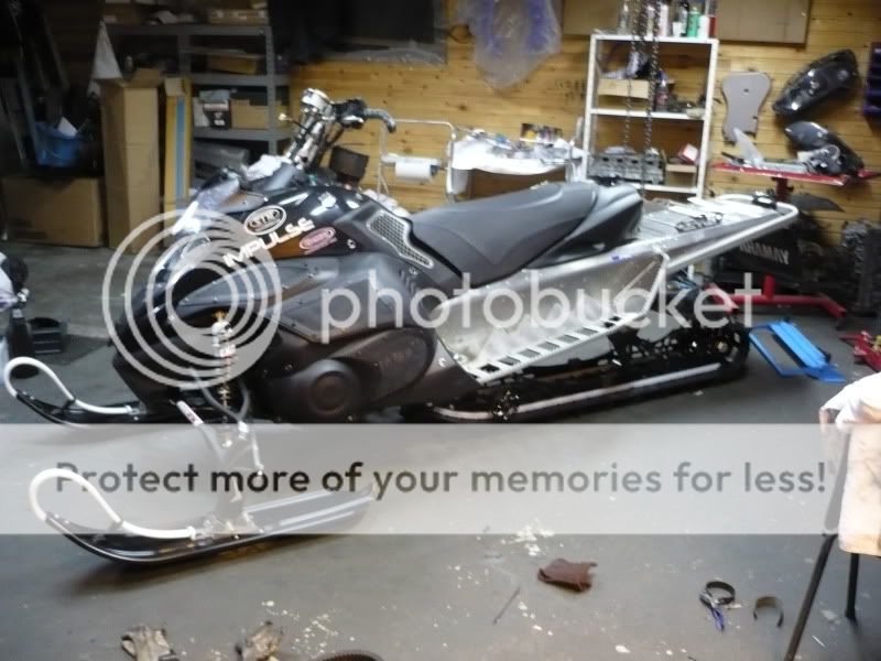

snopro442 said:I just placed an order for the zbros kit, cant wait to do the install!!!
snopro442,
If you are planning on keeping your fox shocks, i just hope they are standard Float X. Cause the E-Vol's wont work with the Z-Broz kit as you will need to turn the bottom half of your shock 180 deg.

So the air inlet valve is facing outward and the rebound knob facing inward.

snopro442
- Dec 10, 2007
- 321
- 13
- 1,013
- neenah wi.
- mod 08 nytro, 2-2007 phazers and a 2010 sno pro 500 speedwerx exterminator. new 2014 nytro for towing the snowcoach. 2015 Viper mpi turbo
yes its only the evol's that wont work. The z-broz is narrow where the shock goee in between the upper so the evol chamber wont clear.

Here's mine...snopro442 said:here are my shocks, will they work or not?
